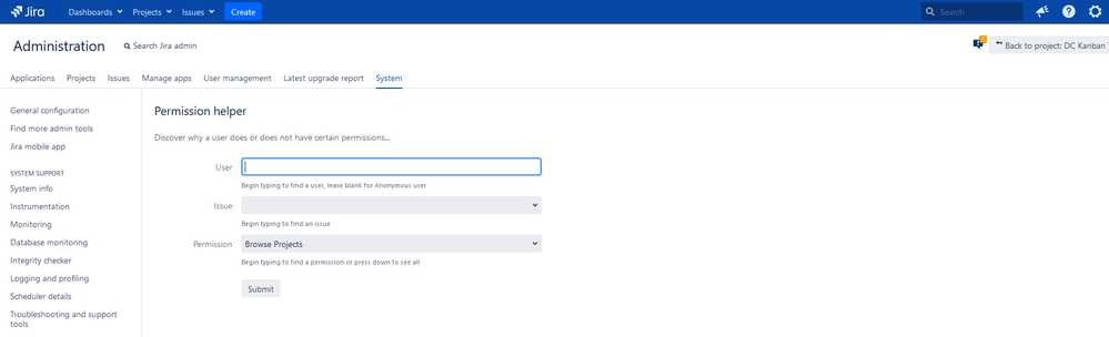

Hi @Oliver Blaskowitz , thanks for your question.
If you are a Jira admin, you can access the Permission Helper in the system settings to check for any blockers to the user being able to create in the different projects.
So, here^ you would put the user and the create permission to see what the results are.
Please can you try this and see if it helps you?
