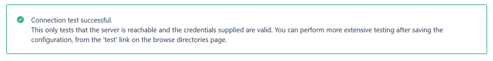

I'm able to connect to the AD server from Jira server on port 389 , also When I test the LDAP connection in Jira web interface it says ok , it says not all tests are performed though

The test I was asking if you performed is the more detailed test rather than the one testing if you can reach the directory. This is referenced in the image you attached as well.
This test goes through various steps such as user presence, group, membership tests to name a few.
Performing it gives you a better idea of where JIRA is failing the connection exactly.
