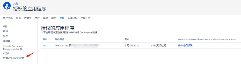

User management for Jira and Confluence established as a local user or through LDAP, or other methods?
Try to check Authorized Applications in this user's personal settings.
jack zhang
October 19, 2021
We use the company's internal identity authentication service (CAS) to login confluence and jira. But we use local user data to manage users.
Ollie Guan
October 19, 2021
这里移除访问授权,重新做一次授权试试吧。
jack zhang
October 20, 2021
尝试过了,还是如此
