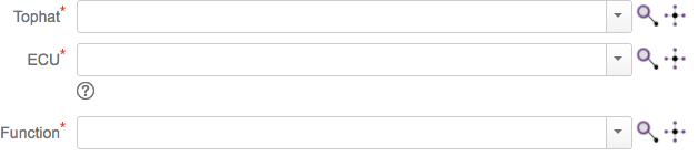

Hi
Have added the following script to a custom field (ECU), in order to show the help icon and when pressed pop up a text. In this case a test text!
The help icon ico_help.png shows up underneath the field rather than between field header text and field.
<a data-aui-trigger href="#" aria-controls="ecu-inline">
<img src="/images/icons/ico_help.png"/>
</a>
<style>
aui-inline-dialog{ max-width: 600px; }
</style>
<aui-inline-dialog id="ecu-inline" alignment="bottom left">
Test for the custom field ECU
</aui-inline-dialog>
Any solutions would be much appreciated!
/Daniel

Hi
The icons to the right is provided by the Add-on Insight.
But I solved it by changing the script now and it looks like this.
<script type="text/javascript">
AJS.$("#customfield_11013").parent().parent().parent().children('label').append('<a data-aui-trigger href="#" aria-controls="primary-indicator-inline"> <img src="/images/icons/ico_help.png"/> </a>')
</script><style>
</style><aui-inline-dialog id="primary-indicator-inline" alignment="bottom left">
    Text to be shown when clicking the question mark icon

I know this is a bit old but maybe a small improvement here could be this:
AJS.$("label[for='customfield_11013']")
instead on going through the parent() tree to find the element (which is likely subject to change in the future with a different layout) using "label for" is an HTML5 standard to find the label that applies to element with a certain ID
... and it is way a bit easier to read :)
