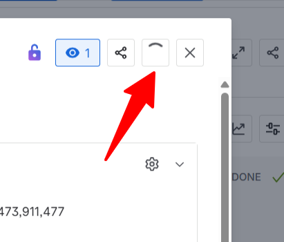

Hi everyone,
I've built a Forge app with a jira:issueAction module. When the action button is clicked, it triggers a function that performs several async tasks and returns a response at the end. The function completes successfully — I can see the final logs, and there are no errors or unhandled exceptions.
However, the issue I'm facing is that the Jira Action button keeps spinning and doesn't return to its normal state unless I manually refresh the page. I've tried returning different response types (string, JSON object, etc.), but the behavior remains the same.
Has anyone experienced this? I'd really appreciate any guidance or ideas on what might be causing the action to hang like this.
Thanks in advance!

Hi @faridmirahadi
Could you share which function you're referring these values from? Your `jira:issueAction` object should have a `resource` attribute that specifies a UI Kit or Custom UI resource that provides the UI for your app, which will be displayed in a modal that appears after your issue action is selected. If this is a UI Kit resource (i.e. a `.jsx` file) your function should be returning JSX components — not JSON or a string.
Would it be possible to share your manifest and the function that is backing your `jira:issueAction` module? That would help us diagnose what is going on.
cheers,
Tim

import api, { route, webTrigger } from "@forge/api";
export async function run(event, context) {
try {
console.log('SMS Action - Event received:', JSON.stringify(event, null, 2));
console.log('SMS Action - Context received:', JSON.stringify(context, null, 2));
let issue = null;
if (event.context?.extension?.issue) {
issue = event.context.extension.issue;
} else if (event.context?.platformContext?.issueKey) {
try {
const response = await api.asApp().requestJira(route`/rest/api/3/issue/${event.context.platformContext.issueKey}`, {
method: 'GET',
headers: { 'Accept': 'application/json' }
const data = await response.json();
issue = { key: event.context.platformContext.issueKey, ...data };
} catch (error) {
console.error('Error fetching issue by key:', error);
return { body: { content: "Error fetching issue by key." } };

Tim Pettersen
July 2, 2025
Hi @faridmirahadi
Thanks for sharing your code!
I believe the issue is in your `jira:issueAction` module:
jira:issueAction:
  - key: send-sms-action
    function: sms_action
    title: Send SMS Update
    icon:
      url: https://cdn-icons-png.flaticon.com/512/455/455705.png
    action:
      response:
        type: text
The "action" property isn't valid syntax, and a "function" can't be specified at the top level. Was this generated by an LLM by any chance? It may be confusing the module syntax with a feature from another platform, or hallucinating an action response type.
A typical `jira:issueAction` module looks something like this:
jira:issueAction:
- key: hello-world-issue-action
resource: main
resolver:
render: native
The "resource" specifies a UI Kit resource that will be displayed in a dialog when the user clicks the action button, and the "resolver" specifies the function that acts as a backend for the UI.
If you'd like to see a working example of this, I'd recommend creating a new Forge app using the CLI and picking the Jira issue action template. That will show you the general architecture of an issue action, which you can adapt to suit your "send SMS" use-case.
Hope that helps!
Tim
