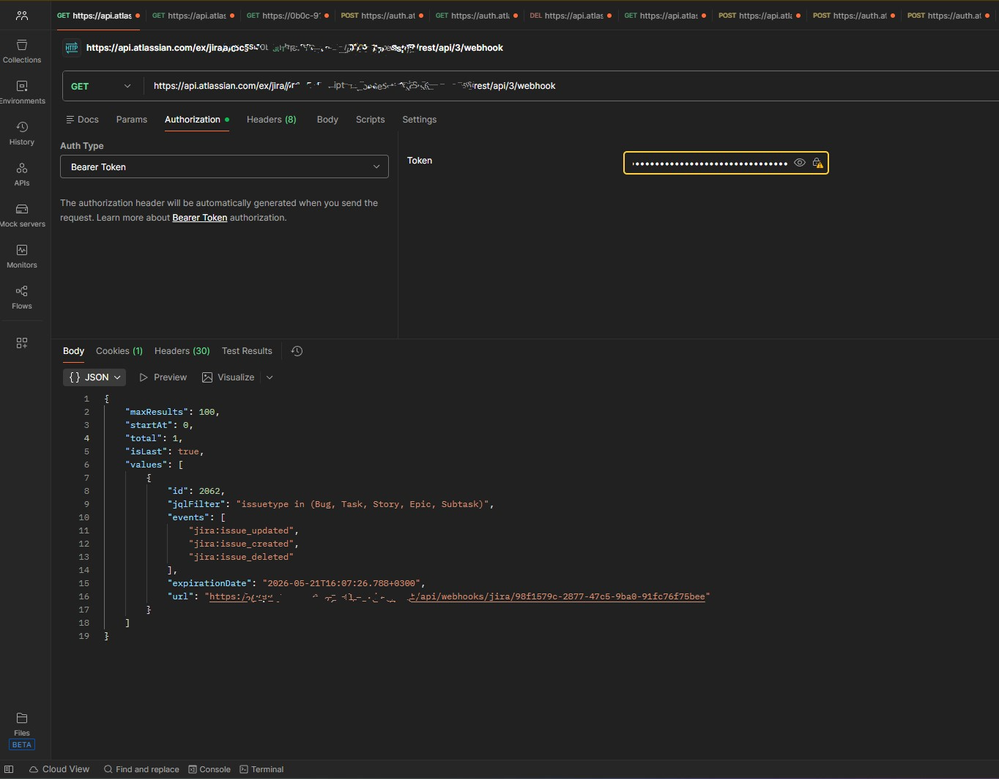

We are investigating a severe and unexpected issue with Jira Cloud webhook delivery that began on Monday, April 20, 2026.
Our application depends on Jira webhooks to receive ticket updates from boards in our internal system. Before that date, webhook callbacks were delivered almost instantly and consistently. Starting April 20, delivery dropped dramatically, in some cases to nearly zero. We now receive only an occasional webhook over a long period of time, even though the webhooks were successfully created and the callback URL is reachable.
We are using the official Jira Cloud webhook APIs, including:
  • Get dynamic webhooks for app
  • Register dynamic webhooks
  • Delete webhooks by ID
  • Extend webhook life
Relevant documentation:
We also attached a screenshot showing the webhook is present and properly configured.
What we have already verified
No configuration was changed on our side when the issue started. We also verified that:
  • the webhook was created successfully through the REST API,
  • it is present and active,
  • the configured events and JQL filters match what we intended,
  • the callback endpoint is publicly reachable,
  • our service is returning successful responses for incoming requests,
  • we are not using deprecated REST API behavior for webhooks,
  • the experimental Get failed webhooks endpoint returned no failed webhook data (used manually in Postman to validate whether any webhook-related errors could take place),
  • Atlassian status pages showed Jira and related products as operational, with no webhook-related incident reported.

Hello @Davyd Melnychuk
Based on what you’ve shared, I wouldn’t worry about your JQL or webhook registration for now. Your filter looks solid, the webhook is active, and the expiration hasn’t passed yet.
The key thing to remember is that the "failed webhooks" log only tracks attempts that Jira actually tried to deliver but ultimately gave up on after several retries. If that log is empty, it doesn't necessarily mean Jira is sending everything; it just means it hasn't logged any specific delivery failures.
Since you're dealing with standard issue events (create, update, delete), these should be consistent even with light traffic. The best way to troubleshoot this is to register the exact same webhook to a second endpoint, something like a request bin. If both endpoints miss the same events, you have a very strong case that the issue is on Atlassian’s side. If the second endpoint receives them, the problem is likely somewhere in your current delivery path or server configuration.
One thing to keep in mind is that since you're on a Free site and posting in the Community, no one here has the "under the hood" access to inspect Atlassian's webhook pipeline or your specific tenant logs. Once you have that side-by-side test finished, your next move should be to take those results directly to Atlassian Support.
Davyd Melnychuk
April 22, 2026
Hi @Arkadiusz Wroblewski , thanks a lot for the suggestions, really appreciate it.
Just to clarify, we’ve already tested this with multiple endpoints, and the behavior is the same everywhere. Some expected webhook events are still not being delivered, and there are no failures logged. Because of that, it doesn’t look like an issue on our side and it’s most likely something on the Atlassian side as you stated earlier.
