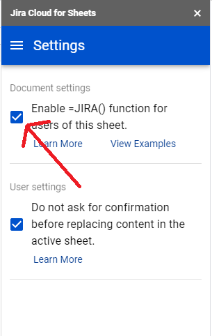

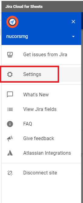

  • First go to Settings and enable 'Jira Functions':

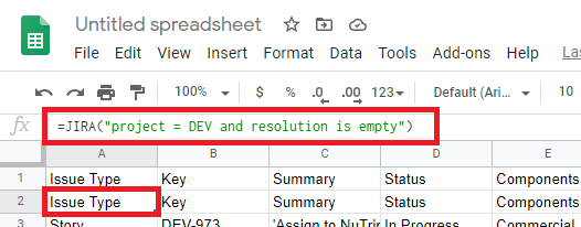

  • After you have inserted the row, create your Jira Function statement in the first cell of row 2 (A:2): =JIRA("project = example and resolution is empty"). Don't forget the quotes around your JQL.
  • You can then format Row 1 with the headers. When the JIRA function refreshes, it will only affect Row 2 and below. You can hide Row 2
