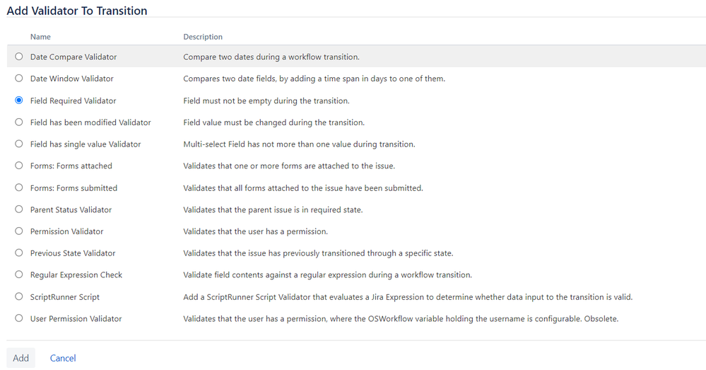

As per your request, You can user Jira cloud in build feature to fulfil this requirement.
  • In PX project, Go to the required workflow then click on edit.
  • Now you can see the option to select Condition, Validation, Post-Function.
  • So we have to select the Validator option from the transition Code Review to Released.
  • In validator, Click on the Required Field then Save the Workflow.
Note :- Try it in UAT environment to, If works then Apply it on Prod.
Accept the answer if it helps
Regards,
Sanjen Bariki

@Sanjen Barikithis workflow is used by many projects.
"One of the transitions of this workflow (which is used by multiple projects) "
I agree with your solution. It  is the simplest form of validation to confirm if a field has been populated but  in @Davide Cartacase it would fail for the other projects where this is not a mandatory field

Hi @Graham Twine ,
Agreed, But In @Davide Carta case he need to setup all the project where that workflow is used So I given the Simplest way to find the solution instead of using the Script. As you know script will be very difficult for the future preference.

hello @Sanjen Bariki ,
thanks for the answer.
if I use the pre-set validator option, as you suggested, is it not going to be applied to all the projects using that workflow?
only one project uses that field.
that is why I am thinking about the script
thanks
Sanjen Bariki
June 2, 2023
Hi @Davide Carta ,
Warm Greetings!
Below added the response inline.
  • if I use the pre-set validator option, as you suggested, is it not going to be applied to all the projects using that workflow?
:- Yes, It will use for all the projects, Where that workflow is used.
Example:-
Project name ;- PX
Workflow Name :- Story and task Workflow But this workflow shared with 15 projects.
In the above case If you used the Validator in the Story and task workflow then the Custom field (Story Point)  validator will be Apply in all the 15 projects.
Note:- If you are changing anything in the Workflow then that will reflect in all the projects where that workflow is used.
