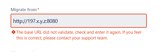

Made another try to migrate old (7.6.x) local Jira server installation to cloud. Got help to NAT my pc so I can access it on internet like http://197.1.2.3:8080, everything looks normal there. But when I try to "Migrate t cloud" using Jira Cloud Migration Assistant I still get the error "Base URL did not validate".
I tried to change the base url in my Jira to this external adress, but still same error.
Can it be that I uses numerical ip of the Jira access? Or hpps instead of https?

Nic, sorry to bother you with more replies; I think I have everything set up for Jira Cloud Migration Assistant, but it won't connect to my local Jira that is accessisble on internet in the form http://1.2.4.5:8080 as descibed above. I feel I am so close migrate the whole site... Just one final step.
I looks like the migration web page does not try to connect, I get the error immediately, like "error- your email adress is malformed".

I could migrate now, I set up a temporary name in our dns, so I could use a domain like http://temp.our.site.net:8080, and now the migration tool works!

January 21, 2021
So how are you exposing your local Jira to the internet?  What port forwarding or proxying have you set up?
Ola Arwidsson
January 21, 2021
Got hep from our internet provider, they mentioned NAT. Not sure about details, but some general kind of port forwarding from <internet-ip:8080> to <local-ip:8080>.

My ip is on the internet, I can easily access my local Jira with http://1.2.3.4:8080
Nic Brough -Adaptavist-
January 21, 2021
You cannot use the numeric IP because that's only available inside your network, behind your NAT as far as the internet is concerned.  The migration assistant needs to be able to read it.
You'll need to do some proxying and port-forwarding, based on the external ip address of your network.
