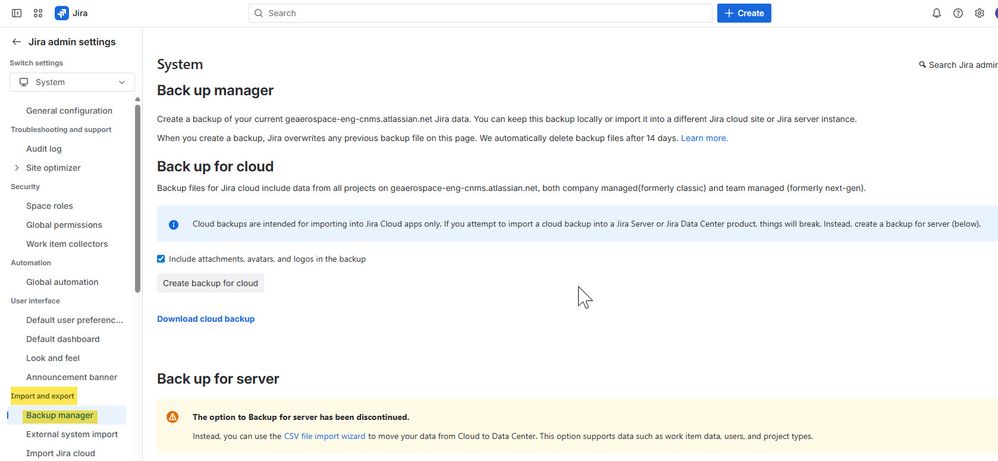

Thanks Marc. We have not installed any 3rd party add-ins for backups. Therefore, I believe this is an OOTB solution from Atlassian. Providing a screen shot as reference.
Hi @Joe Rigley
This is the main backup, this is not an option in Project Settings, but in System Settings (this threw me off).
This backup option, creates a full backup, so all projects are included.

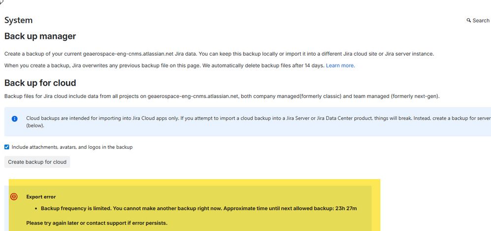

Hi Daria - Thanks for the welcome. Your response aligns with what I was thinking, but not able to verify - thus the community reach out. The only thing that gives me a moment of pause is there is a 48 hour duration limit per back up request. When I go to the Settings' Backup Manager of the 2nd project in our instance and attempt a backup, I get denied with the attached error. Essentially, I have to wait 2 days for each backup. That limitation does not scale. If I had 15 projects, it would take me a month to back each of them up using the presumed OOTB Jira backup option. (Which is why I may need a 3rd party solution such as the GitProtect option you recommended).
Does anyone definitively know the backup manager's scope and/or why there is a 48 hour duration limit on backups?
The attached screen shot is taken from the 2nd project's Settings' Backup Manager feature. (It says the same thing on the original project too).
