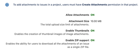

We've been alerted that our Jira Cloud account is nearly out of free space. In my efforts to cleanup our instance, I've noticed that some teams have attached massive videos to some tasks. These videos appear to exceed the attachment size limit set in the Jira administration.
Question: Is the attachment limit no longer enforced?
Configuration
Jira Cloud  attachment size limit set to 10MB.
