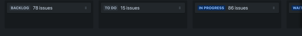

If go to configure the board I can see the all ticket totals.
To Do has 6 visible on the board but in configure it shows the total of 15. it's the same for all the stages.

Backlog is the same. See attached image of the difference.

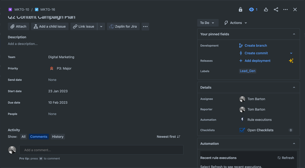

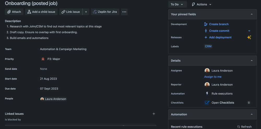

ok so we need to understand what is different between an issue in the To Do status that is showing on the board and one in the same status that is not showing on the board. Can you share a screen shot of the detailed issue view for each issue?
Tom Barton
August 30, 2023
Hi, here are two screen grabs
Top one is on the board and timeline view. The one below is only on timeline not on the board...
