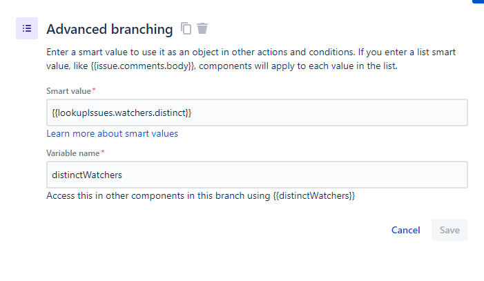

So, for the second point we have tried to modify the automation to get the dinstinct watchers in the For each: smart value step
{{lookupIssues.watchers.distinct}}
{{lookupIssues.watchers.split(",")}}We did several attempt trying to look at the documentation and at other post, but there seems to be no way to get dinsinct watchers and then send a single mail to all the user with the list of Jiras.

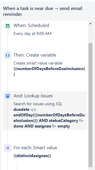

so here some more details.
This is the starting rule:
Where For each: Smart Value is

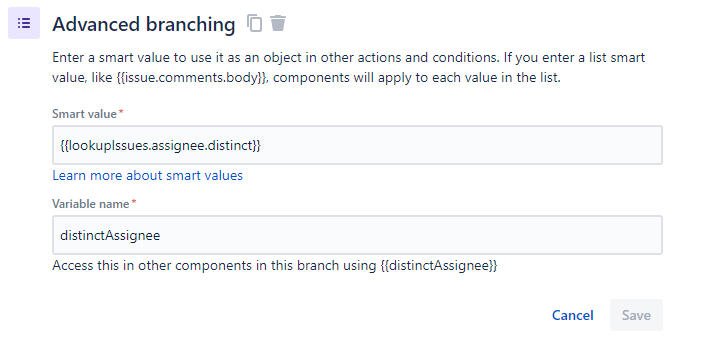

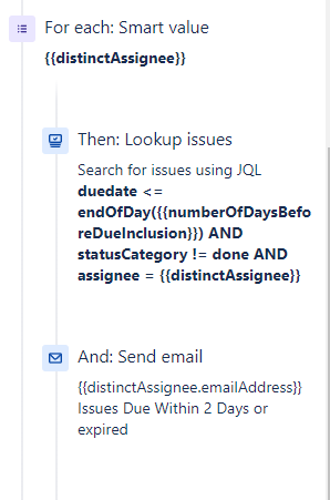

And I'me trying to substitute it with something like
And then

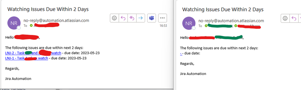

In particular the result of this rule is that I get several email for every different group of watchers:
if there is at least a Jira with only me as watchers in the related email I get the right list of Jira near to due date.
Here what I get when there is 1 jira with just me watching and another with another watcher:
