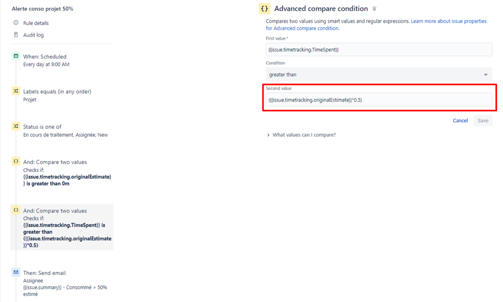

Hello,
I would like setup an automatic rule which send an email when the time spent on a ticket is equal to XX% of time estimated.
I created a basic rule which compares time spent and time estimated, it's works, but when I want to adapt the rule for a certain amout (ie : 50%) it doesn't work.
What I can conclude when I test :
{{issue.timetracking.TimeSpent}}
greater than
{{issue.timetracking.originalEstimate}}
--> OK
greater than
({{issue.timetracking.originalEstimate}}*0.5)
--> NOK (it's triggered even if the time spent is not greater than 50% of time estimated)
I think that the ratio of 0.5 can't be used in this kind of field...
Do you have an other way to set a % of the original estimate ?
Thank you

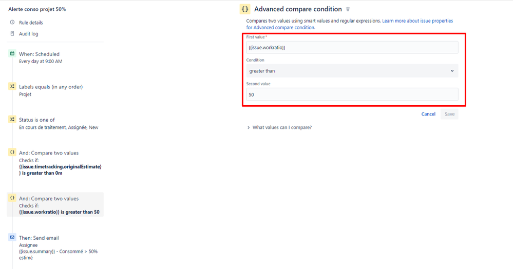

Actually I faced this issue by using workratio field to avoid time estimated calculation :

Do you get multiple emails as time is logged and the workratio is 60%, 75%, 80% etc.?
How could we avoid that and only get the email once?  Is there a flag we can set and have it only send the email the first time around?  I created my own variable but it looks like the scope only exists in that one run of the rule and doesn't persist to the next run of the rule.
Like Gordon McDonald likes this
Gordon McDonald
July 15, 2024
I have the same problem Josh, the email is sent each occasion someone records time spent to a ticket after 50%. Anyone found a solution so that the email is only sent once?
Edit: I added a new label "time-50%-done" to check each time as well, which also gets updated.
