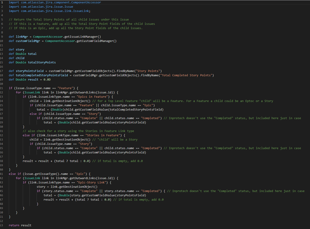

Thanks for the info, @Nic Brough -Adaptavist-
The custom field adds up the Story Points fields for all the child Stories under the Epic. So this value changes when a child Story is Resolved or Reopened.

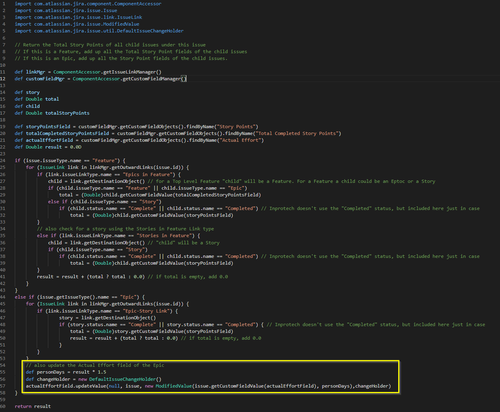

Craig Goulden
February 23, 2023
Hi @Nic Brough -Adaptavist-
Not quite, I think. Ignore the listener code. I gave up on this because I couldn't get it to trigger. The scripted field script actually runs through each child story to sum the Story Points from zero every execution, so it's not cumulative.
I'm not sure if it is the right thing to do, but I got it to work by just adding code to the Total Story Points scripted field to also update the Actual Effort custom field. So I'm updating 2 fields with one scripted field. Doesn't feel right to me, but it works.
I'm not sure what triggers a custom field to calculate but, strangely, I need to refresh the tab displaying the parent Epic twice to see the updated Actual Effort value.
Here's the Total Completed Story Points script:
Does this look alright? Any suggestions?
February 24, 2023
It looks right to me.
You will always have to refresh a page to pick up that a field has been changed outside the current screen.
Like Craig Goulden likes this
Craig Goulden
February 26, 2023
Thanks Nic.
I take your expert opinion as validation :-)
