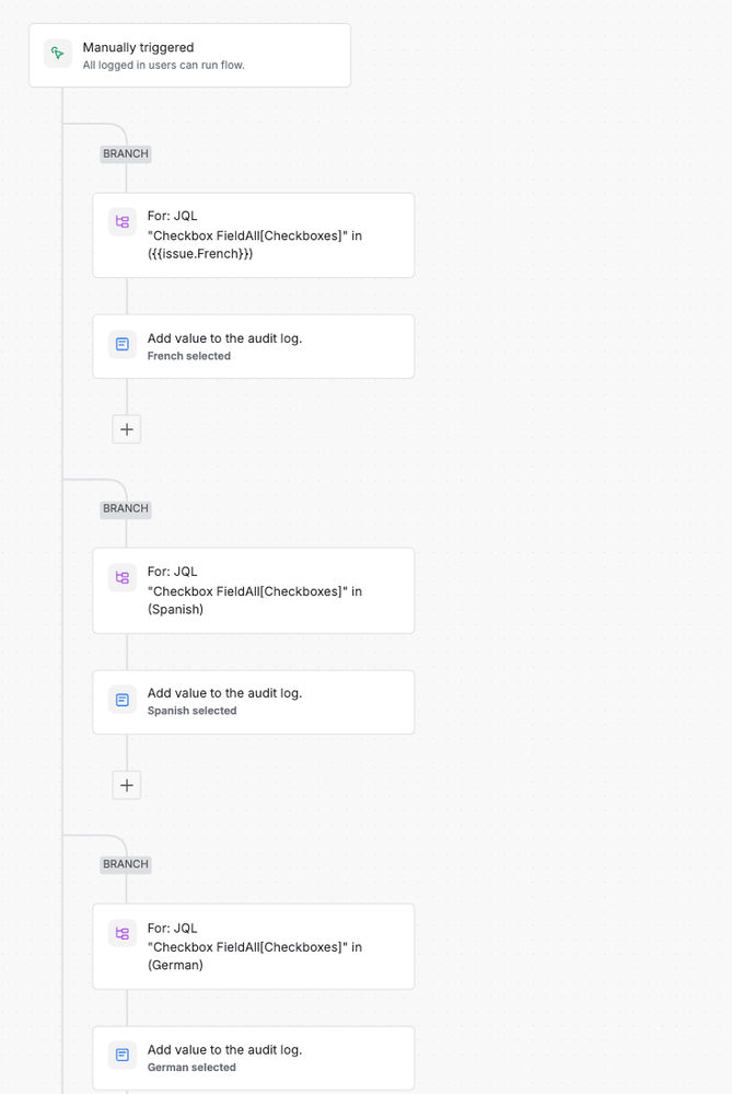

Based I think you are suggesting this:
WHEN issue created
BRANCH Related Issues JQL: Checkbox in (A)
-- Assign issue
BRANCH Related Issues JQL: Checkbox in (B)
-- Comment issue
BRANCH Related Issues JQL: Checkbox in (C)
-- Manage Watchers

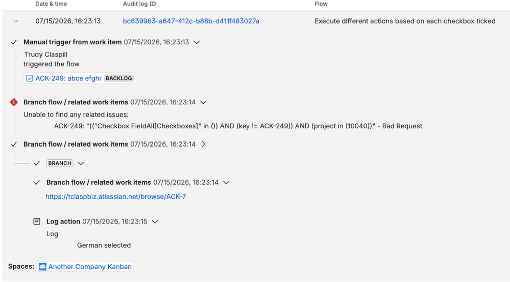

The "BRANCH Related Issues" option excludes the trigger issue from consideration.
Here is my example rule following that format (using just a log action)
I intentionally used a bad smart value in the first JQL so that it would print out the JQL in the error message in the log.
Here is my test issue ACK-249
And here is the Audit Log output.
Notice in the error for the first branch that and key != ACK-249 has been automatically added to the JQL, excluding the trigger issue.
Notice also in the next branch that it executed the JQL I provided but found only the other issue (ACK-7)where I had selected the specified value in the check box

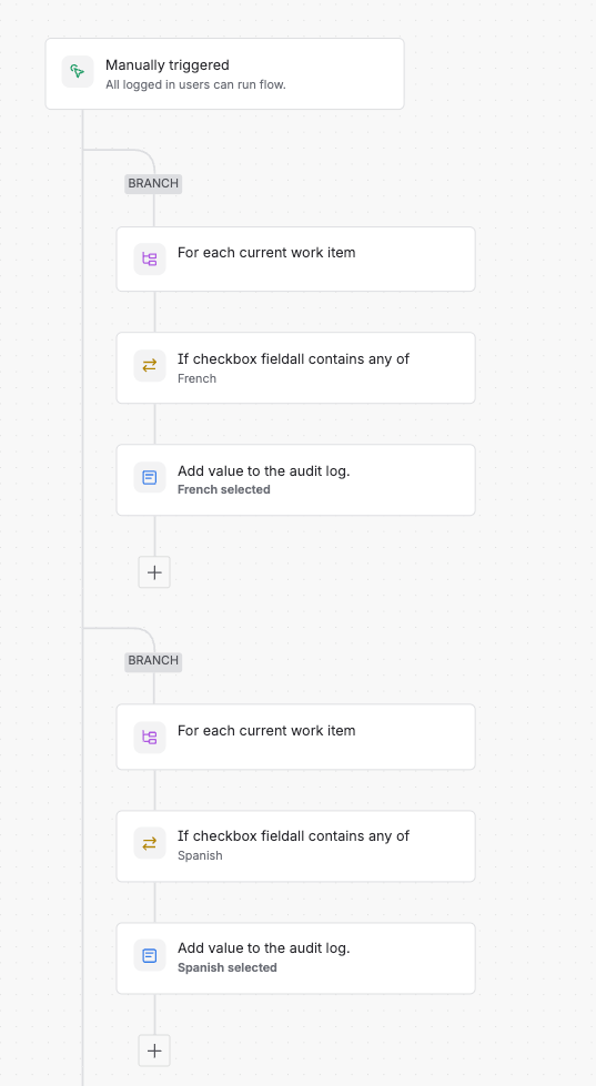

But it occurs to me now maybe what you are suggesting is this:
WHEN issue created
BRANCH Current work item
-- IF Checkbox in (A)
-- THEN Assign issue
-- IF Checkbox in (B)
-- THEN Comment issue
-- IF Checkbox in (C)
-- THEN Manage Watchers
This type of structure does work.

John Funk
August 22, 2026
Sorry, but traveling for a while. Yes, that is what I was suggesting. But what does not work about it? Did you ever get this solved?

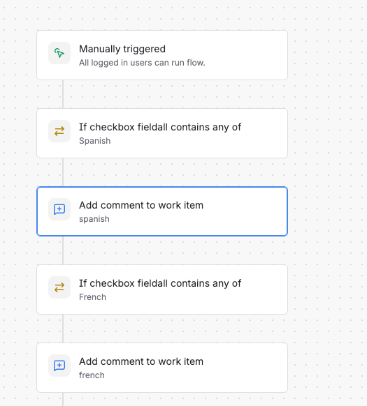

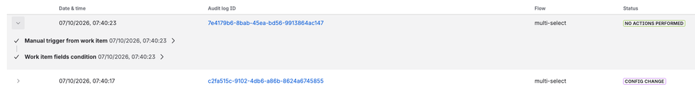

Thank you for your reply, but you are incorrect.
A rule will exit when an IF condition evaluates as false.

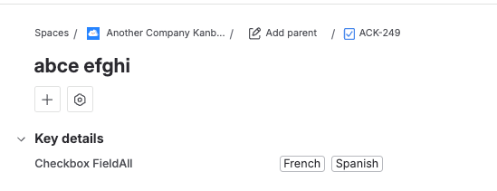

Let us say my field has options: All, French, German, Spanish.
Let us say I set the field in an issue to select All, French, and German; not Spanish.
Let us say I have a manually triggered rule with this structure:
If Spanish then comment Spanish
If French then comment French
If German, then comment German
When I run that rule it stops running at the "If Spanish" block because that condition is not met.
