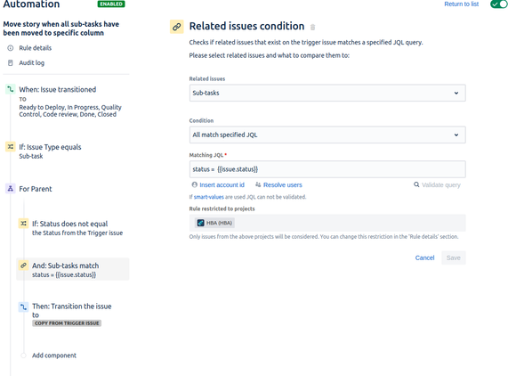

Here is my automation:
I think I'm almost done and I'm close to the answer.
The only field I don't know how to fill is matching SQL filed in the related issue condition section.
I want to say if all subtasks status is equal to the status of the trigger issue then make the transition.
I tried {{issue.status}} but it's not work.

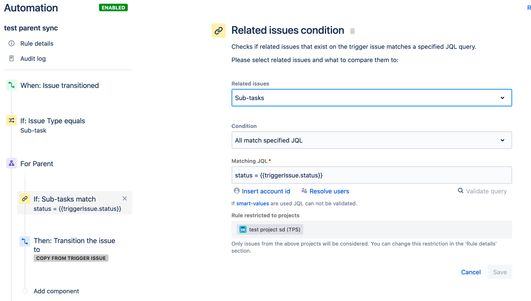

Even if the issue does not match the condition above, the outcome would not cause any difference in the automation result.
Basically, the rule below should properly work for you:
