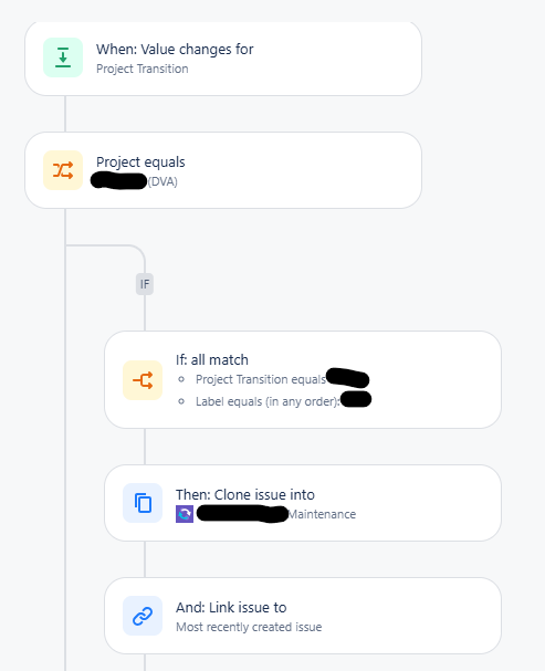

Hello,
For some reason my Jira Automation is unable to clone a ticket from one project to another because it's running into this error:
Clone Issue
Error creating issue
Bad Request (400)
Issue was created successfully, however some unexpected errors occurred -
LINK ISSUES
Error linking issues
: At least one of 'id' or 'key' is required to identify an issue.
Also, it says the issue was created successfully, but when I try to find the cloned issue there is nothing to be found.
Here is how the automation is set up:
There are no issues in the automation until it gets to the cloning/linking part.
Our actor is also Jira Automation, so there is no issues with a user not having the correct privilege.
I have tried to manually clone the problem issues, and they will clone, just not through the automation.
I also tested a few issues from last quarter, and they are able to clone from the automation. I even tried some manual test tickets from Q3 and they work as well, so it's not an issue with the fields.
However, I tested a ticket one of my team members manually created for Q3 and we could not get it to clone through the automation.
I am worried there may be an issue with previous quarter and current quarter tickets because of how they were imported. I am a bit skeptical because there are also issues with manually created tickets.
Previous quarter tickets were imported via the External System Import in the system settings. This quarter, the tickets were imported via the 'Import issues from CSV' button. Despite this, all the files we have ever uploaded to create tickets have always been CSV files, so that has not changed.
I don't know if this is a bug or if it is user error.
Thank you!

Hi Everyone! The issue was that it was a multi project clone and the source ticket from Project A did not contain of all the required fields to create a ticket in Project B. Thank you all so much for your help :)

Bill Sheboy
November 14, 2024
Hi @Kathryn Kerr
What is the scope of your rule (in the details at the top): single-project, multiple-project, or global?
A single-project scope rule can create / clone issues into other projects, but it cannot access them otherwise.  Link Issues is trying to edit the other issue, and so that will fail in a single-project scoped rule.
To solve this, please change the rule scope to multiple-project (or global as needed).  Your Jira Site Admin will need to help do that change in the global automation area of Jira.
Kind regards,
Bill
Trudy P Claspill
November 14, 2024
It is possible to create Links within the Clone issue action, isn't it? Would that circumvent the problem?
Bill Sheboy
November 14, 2024
Hi @Trudy P Claspill
Yes, that is possible for one-and-only-one link during issue create.  (I believe that is all that is currently supported by the REST API.)
So, the workaround for a single-project scope is to add the link with JSON like this using an update in an advanced edit:
"update": {
"issuelinks": [
"add": {
"type": {
"name": "Relates"
"outwardIssue": {
"key": "{{triggerIssue.key}}"
I just tested to confirm this still works for issues created in other projects with a single-project scope rule.
Kind regards,
Bill
Like Trudy P Claspill likes this
2 votes

Trudy P Claspill
November 14, 2024
Hello @Kathryn Kerr
What is the output in the rule execution log?
The trigger is a Field Value Change, but is that change coinciding with the issue being created, or is that change happening on issues that already exist?
If it is on an issues that is has just been created then you might want to try adding a Re-fetch action.
