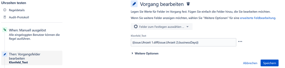

I recreated your use case and this solution worked for me:
{{issue.Uhrzeit 1.diff(issue.Uhrzeit 2).businessDays}} -> returned the difference in days
{{issue.Uhrzeit 1.diff(issue.Uhrzeit 2)}} -> returned the difference in hours
What type is the field you are editing? I used a textfield which works fine.
"Uhrzeit 1" and "Uhrzeit 2" are my test fields.

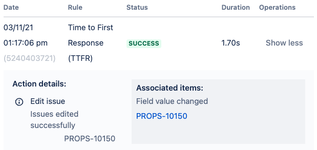

Here's my audit log for the automation (success) for the result custom field... Result - Time to First Response (my result custom field - text) is "None".

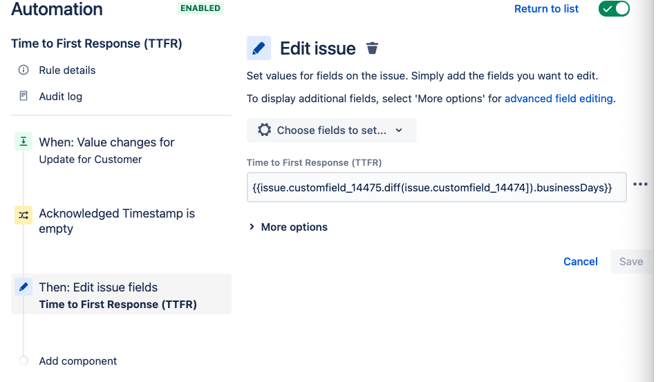

This is what my automation looks like:

Update - my automation still had issues. The first time the value for "Update for Customer" field changed, the automation for the calculation ran successfully but no results as earlier.
Interestingly, the second time the "Update for customer" field is changed, the results were successfully outputted in the screen.
My analysis (by using @Lisa Grau manual trigger idea, suggested me value change triggers were causing it.
I just solved the issue by creating a manual trigger like Lisa suggested to run every night at 12 am.
