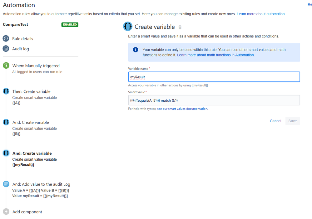

So I have created the following automation:
1. Create Variable:
Smart value: apple
2. Create Variable:
Smart value: apple

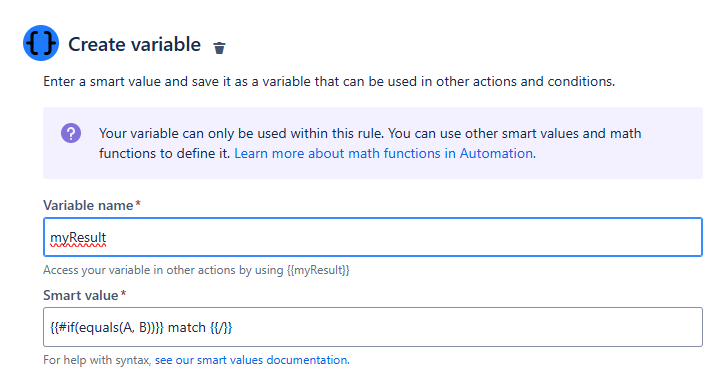

3. Create Variable:
smart value: {{#if(equals(A, B))}} match {{/}}

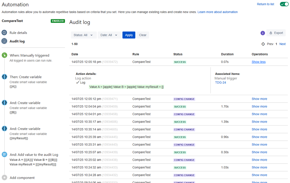

4. Log Value:
myResult: {{myResult}}
myResult is empty in the log.

Dominic
July 14, 2025
Hi Dick,
many thanks for the reply.  Here's my output..
Sometimes there are just days when you think you're crazy and this is one of those for me!

oh, and for completeness: the if statement I defined is the same as yours:
Like Calvin likes this

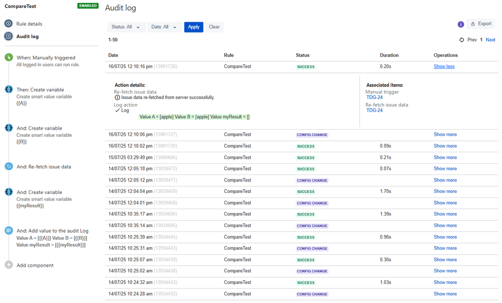

Try this:
Insert a new action of Re-fetch issue data after variables A and B are set AND before you create the myResult variable.  This should allow for the first two variables to have been created and have their values set before you create the third variable which depends on their comparison for a value to set as expected.  You can set a delay execution of a second or two should suffice.

Dominic
July 16, 2025
Hi @Andy Heinzer
sorry, adding a refetch didn't help:
