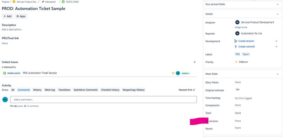

Having this issue where within my Jira Automation where I create a new issue as a result of a label added to a ticket. The new ticket is supposed to have a different fix version, but even though the automation generates the new ticket and the automation log is "Success" --it continues to drop the Fix Version.

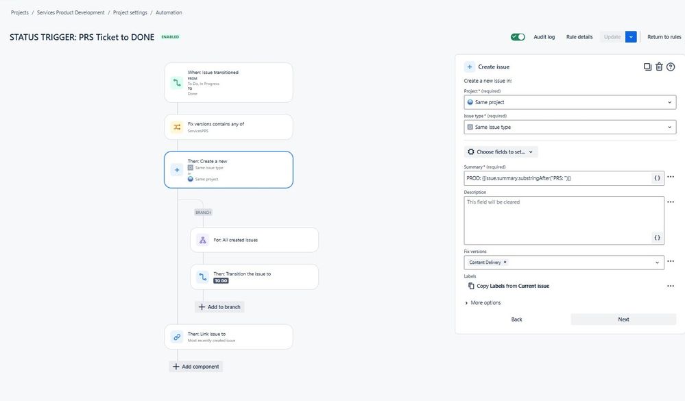

The fix version is selected in the gear dropdown of "Choose fields to set"

  • an image of your complete automation rule in one image file,
  • images of any relevant actions / conditions / branches,

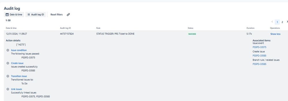

  • an image of the audit log details showing the rule execution, and

  • Fix Version is not being added in derivative ticket. I am not aware of any particular nuances that is resulting in it not working. This same process (cloned with different labels and fix version) works - so perhaps it is the fix version itself.

Thanks for this information, and I just replicated this symptom so this appears to be a defect where:
  • at this time, the Fix Versions cannot be set from the dropdown field in the Issue Create action, and...
  • immediately after the issue is created, the Fix Versions cannot be set using the Edit Issue action
I also tested to confirm this was not caused by a version name collision effect.

For a workaround, you may used advanced edit with JSON to set the field rather than using the dropdown list: https://support.atlassian.com/cloud-automation/docs/advanced-field-editing-using-json/#Fix-Versions
After you remove the field in the Issue Create action, expand the More Options area and enter this expression:
"fields": {
"fixVersions" : [ { "name": "Content Delivery" } ]
Kind regards,
Bill
