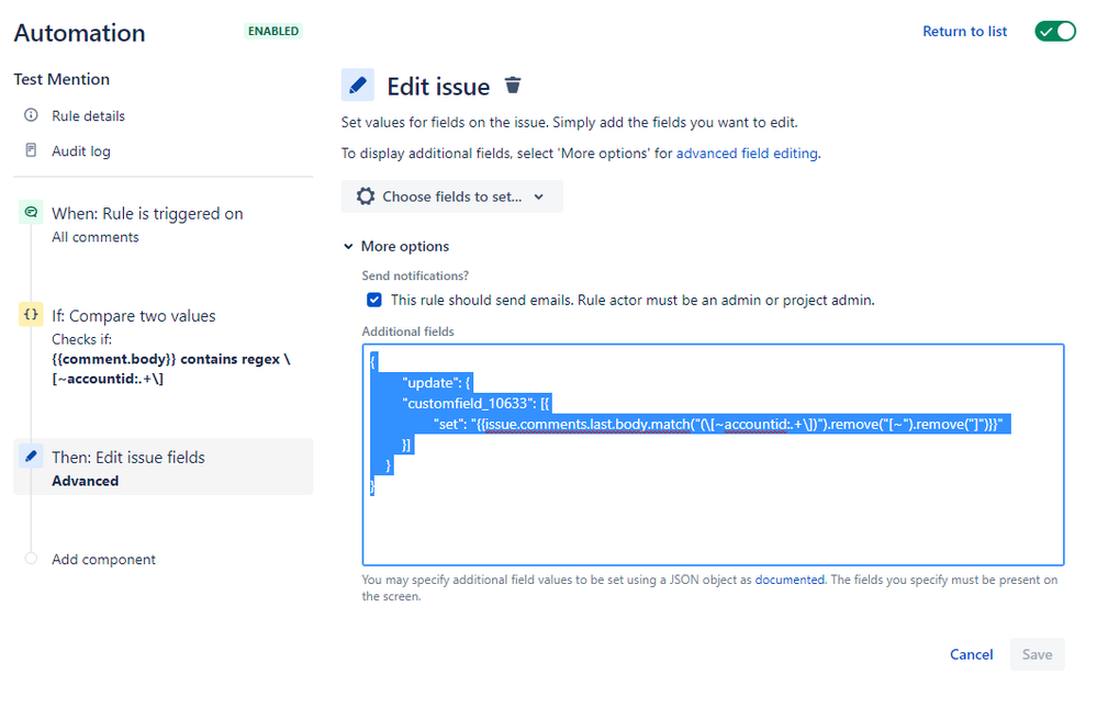

I'm currently running the below automation, which outputs the user ID of a user mentioned in a comment like this :
"accountid:123a456b7891be664"
I'd like to change update a custom user picker field with the account id that has been extracted from this, I can change the JSON to add or remove bits around the string, however I haven't been able to get the custom user picker field to accept anything I've thrown at it so far.
The regex that finds the accountid is :
\[~accountid:.+\]
And the JSON is :
"update": {
"customfield_10633": [{
"set": "{{issue.comments.last.body.match("(\[~accountid:.+\])").remove("[~").remove("]")}}"
Any ideas on what I'm doing wrong here?

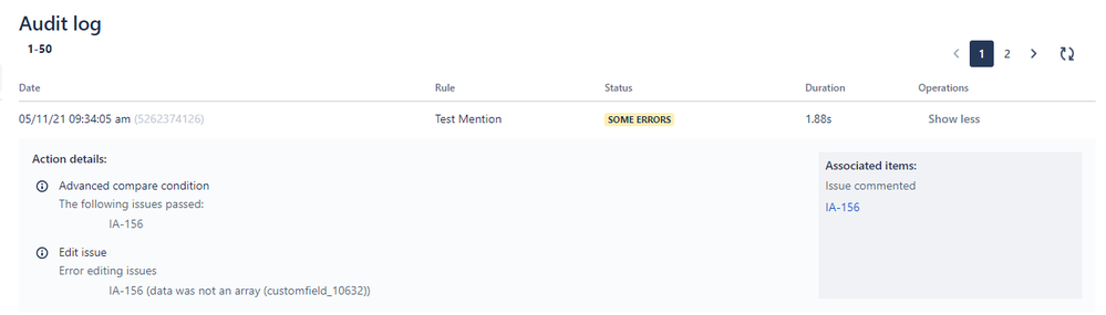

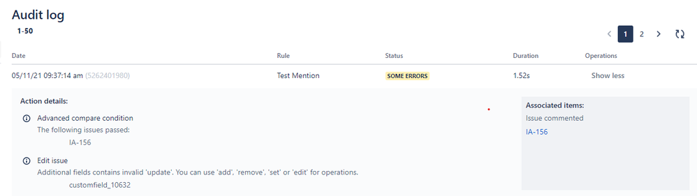

Hi Sebastian,
Thanks very much for your reply - super appreciated as I'm absolutely banging my head against a wall on this one, unfortunately there's no luck with your suggestion either. Below is your snippet and the error it threw, then my attempt to tweak it with it's failure log as well. Just a heads up that customfield_10632 the correct value for my custom multi-user picker, whereas my original post had 10633 which is a custom rich text field I've been using to test the output. I ran both of the below through both fields and got no results.
"update": {
"customfield_10632": [{
"accountid": "{{issue.comments.last.body.match("(\[~accountid:.+\])").remove("[~").remove("]")}}"
"update": {
