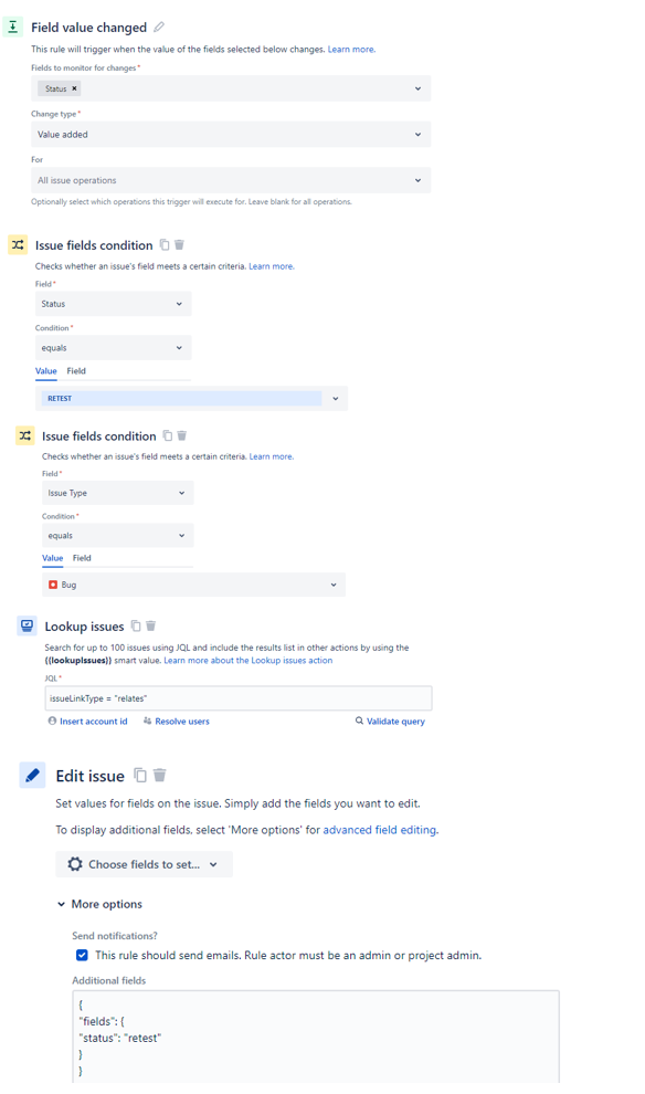

This is the automation rule we have so far:

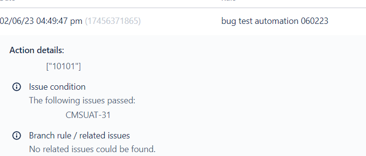

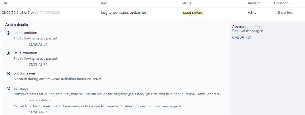

This is the audit log, where CMSUAT-31 is the bug created from the test execution not found:

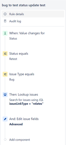

Can you also show us an image of the components in your automation rule (the part that displays to the left as a tree)?
I think one thing you probably need to do is replace the Lookup Issue action for a Branch / For Related Issues / Linked Issues step, and put the Edit Issue action within that branch.

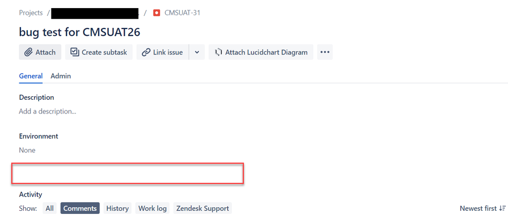

This is CMSUAT-31, bug created from CMSUAT-26 test, but as you can see, there's no apparent link on the bug screen as we would expect based on the zephyr settings (in our configuration, the linked issues would typically appear between environment and activity):
These are the components of the rule I think you're asking for - let me know if that's not what you needed.

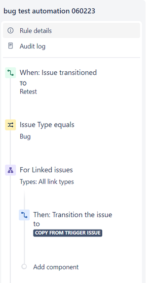

We did try another variation using the branch feature, but it's not giving us the results we're looking for either:
This one appears to not be finding any linked issues either:
