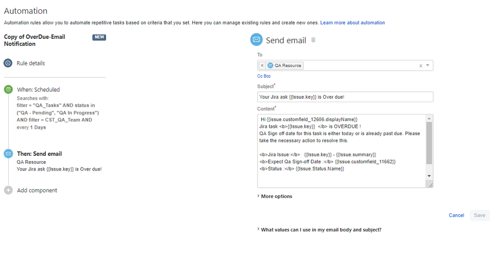

I want to find and cancel the scheduled email notifications in Jira. I have created a Jira automation rule to check if a task is overdue and send an email to the assigned resource. The JQL provides the correct Jira issues to be sent out via email. However, the emails are being scheduled to be sent out even when conditions in Jira are changed, and they should no longer pass the JQL query. I have now disabled this rule, but I am still receiving notifications for those Jira issues that were scheduled to be sent out earlier. How can I find the scheduled email notifications and cancel them in Jira?

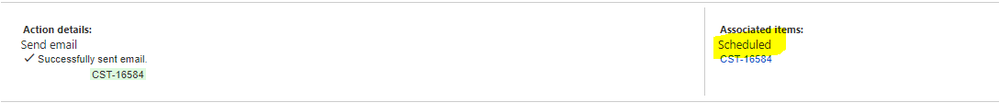

Here is my automation rule and audit detail where a jira issue was selected but it shows scheduled to send email.  Please help.

Hello @Bill Sheboy , Thank you for your response. I already checked running the query stand-alone, I don't see any unexpected results. From what I understand, JQL finds correct issues and passes to next action which is send email, where instead of sending email at the time of execution, somehow this is scheduled to send out emails later and that too daily. Now these scheduled emails are coming out even after task is moved to different states and out of scope from JQL standpoint.  And I have no other rule that is sending email notifications.

I do not see a date/time stamp in the audit log you are showing.  Are you stating that the email is sent long after the rule has run?

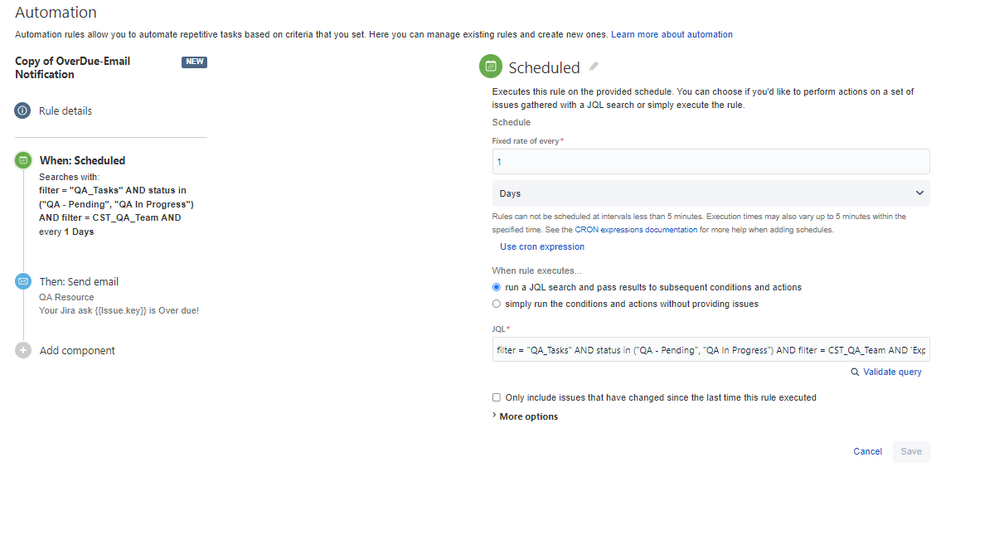

And, your rule's scheduled trigger is daily only.  This means it will run once per day, at the time when the rule was published, and not at a specific time of day.  If you need the rule to run at a specific time, please use the advanced options with a CRON expression.

Yes @Bill Sheboy , Emails are sending out regardless of rule now.  You can see I have disabled the rule since 11/19 but still getting emails everyday. Rule Itself was scheduled to run every day when it was enabled.Capture4.PNG
