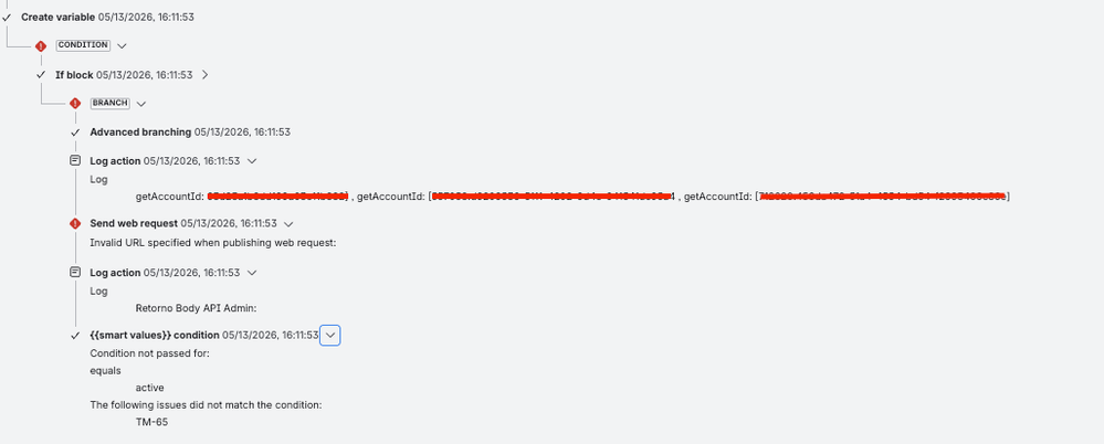

Unfortunately, this is not working correctly.
Inside the Advanced Branch, {{getAccountId}} is coming empty in my environment.
Because of that, the Admin API request becomes:
/users/
instead of:
/users/{{accountId}}
which causes the API to return the first page of users from User Management.

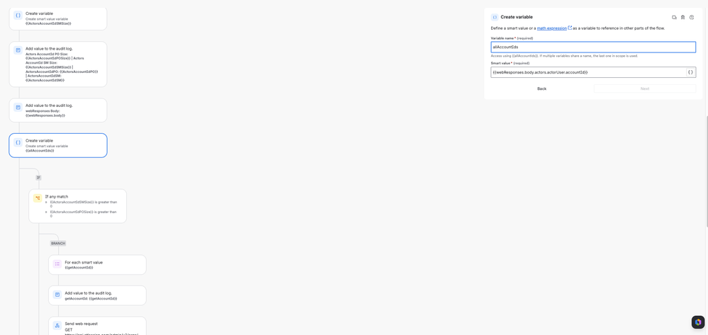

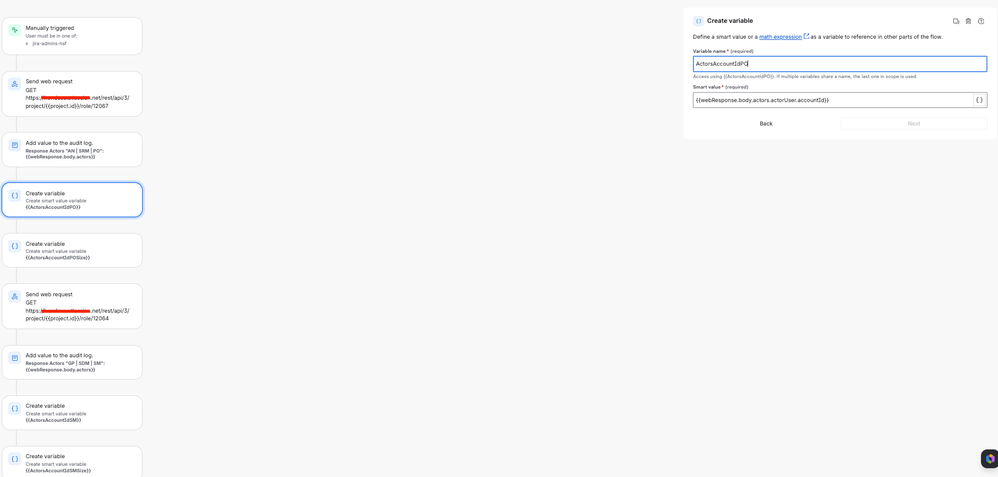

Yes, I believe the main problem in my case is currently inside the Advanced Branch logic itself.
My current flow is basically:
GET Role PO
Store accountId actors PO in variable
GET Role SM
Store accountId actors SM in variable
Store all accountIds
Verify if at least one accountId exists

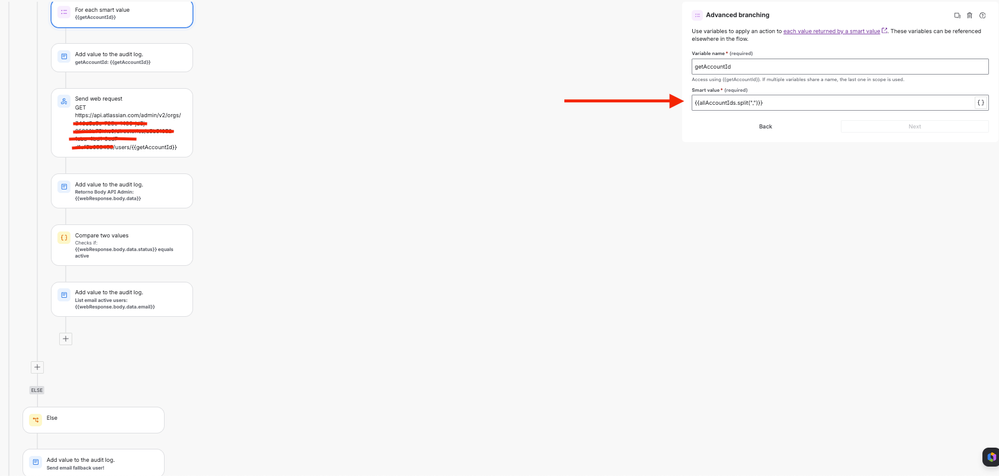

Advanced Branch: {{allAccountIds.split(",")}}
↓ GET Admin API
↓ Validate active user
Send Email
ELSE
Send fallback user email
However, the iteration is not working correctly the way I configured it.
I still have concerns regarding the reliability of deduplication, especially in scenarios where the same user belongs to both Project Roles.
At the moment, I’m not fully confident that Jira Automation handles array manipulation and deduplication consistently enough for this type of logic.
Thanks again for sharing your example — it was very helpful as a reference!

However, because I needed to merge the results from both Project Role requests, Atlassian Support recommended using webResponses (with “s”) to access all previous web request responses together inside the same rule and webResponses.body is actually returning data correctly from both requests.
I added a Log Action with:
webResponses Body: {{webResponses.body}}
So at this point I believe the challenge is more related to how Jira Automation handles array parsing / iteration from merged webResponses rather than the API response itself.
I also agree with your point that Automation may not be the ideal tool for this level of data processing and deduplication logic. :/
Thanks a lot for your help and insights!
