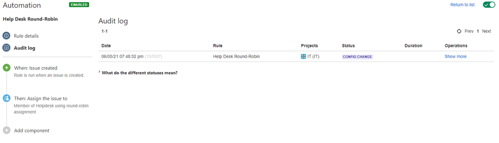

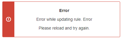

I have created a new jira automation for round robin assigning tasks but it seems to never trigger. Also when I try to turn off or on any automation, or make changes to existing rules I get an unspecific error. I've attached the rule and how it's configured, and as you can see from the audit log, it's never triggering. I've also added a photo of the error i'm getting when trying to turn off a rule or edit a rule.

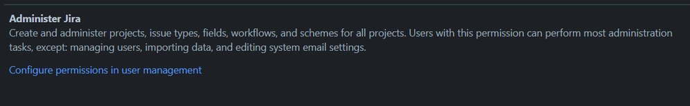

You need to be an ORG ADMIN for create\edit automation rules.

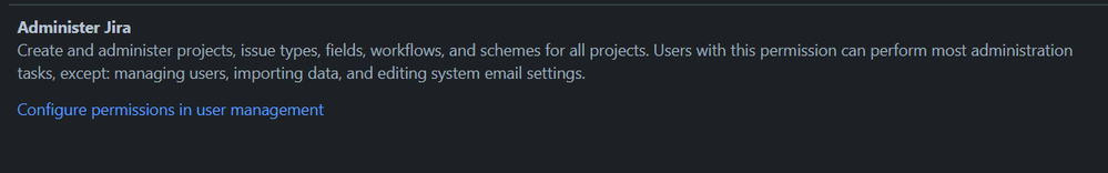

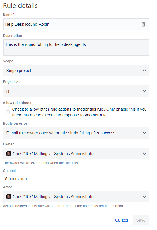

Can you share a screen shot of your Rule Details page?
Does this Rule get called from another rule possibly? If so, check the box on the Details page.
Be sure to save and publish the Rule.
Chris Mattingly
May 7, 2021
I just made this new so it should not be called by anything else.rule detail.PNG

Any time I try to make any changes I get "an unknown error occurred. Please reload and try again" no matter what I do. Where can I view this error?

Yes, if I try to turn it off or on I get that error. And if I go into it to make changes i get that error
