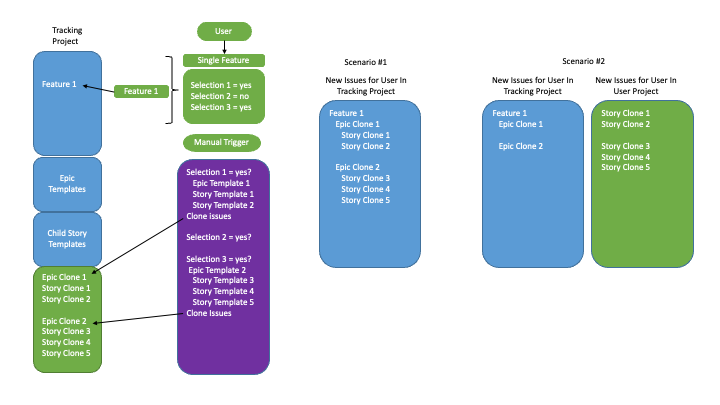

Don Hames
February 20, 2023
@Bill Sheboy, I'm visual, so maybe I can better explain this with a graphic.
The Tracking Project contains all the Epic and Story templates needed to create a Tracking Feature for a user. The user creates a new Tracking issue in the Tracking Project. On the Tracking issue, there are several choices that the user makes their selections from Select List (single choice) custom fields.
Users execute the manual trigger on the Tracking Project Feature issue when their selections are complete. The Manual Trigger automation rule executes, and based on the user's selections, it clones the appropriate Epics and Stories in the Tracking Project.
The user will use these to complete the Stories, which can be followed in the Tracking Project.
Problem:
Since the Manual Trigger rule was associated with the Tracking Project Feature, cloning the Epic and Story templates fails as it clones the Tracking Feature, not the Epics or Stories. I have used several methods to select the Epics and Stories, but they all result in cloning the Feature. The {{triggerIssue}} and the {{issue}} refer to the Tracking Feature.
Questions:

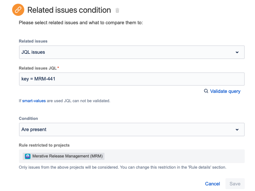

How can you select a different issue, i.e., the Epics and Stories, in the same project and clone it correctly? I have tried every issue condition type with the JQL selection of key = Epic-101, and none of them result in the successful cloning of the Epic. All attempts result in cloning the Tracking Feature.
Here is the issue condition trying to select Epic called MRM-441.
Here is the overall flow of what the automation needs to do:

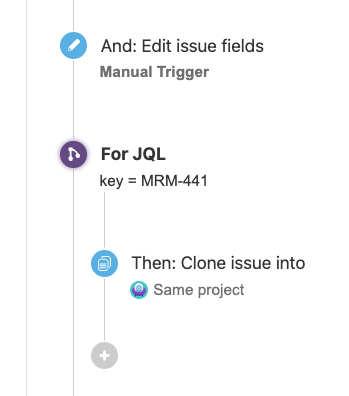

Don Hames
February 20, 2023
I followed your suggestion:
  • trigger: manual
  • condition: issueType is Feature (just as a precaution)
  • branch: on JQL to select your template issue for an epic
    • action: Clone (this will attempt to clone the epic referenced in the JQL), setting the parent to the trigger issue's key
    • ...as needed, repeat to add any other epics based on your fields
The cloned record was a clone of the Feature. Here is the branch to select Epic, but it did not work.
Bill Sheboy
February 20, 2023
I just tried this and it worked as I described, where the cloned issue is from the branched-to issue...not the trigger issue.
Please post images of the audit log showing the details of execution when the rule does not work as you expect, and of the details of your Clone action.

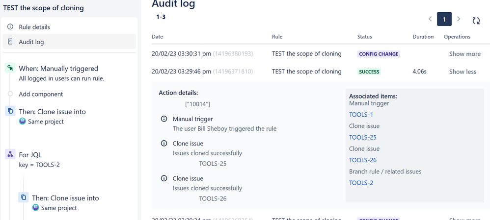

Bill Sheboy
February 20, 2023
Here is my test rule for cloning from the branch.  For this example, I used only user stories.
In my test rule, I have two clones: one after the trigger to test cloning the trigger issue correctly and another inside of the branch, testing that the branched-to issue is cloned correctly.
I cannot see your entire rule, only what you showed.  So I cannot confirm how similar your rule is to this one.  For example, what is the purpose of the edit on the apparent field "Manual Trigger", and what is the actual rule trigger?
