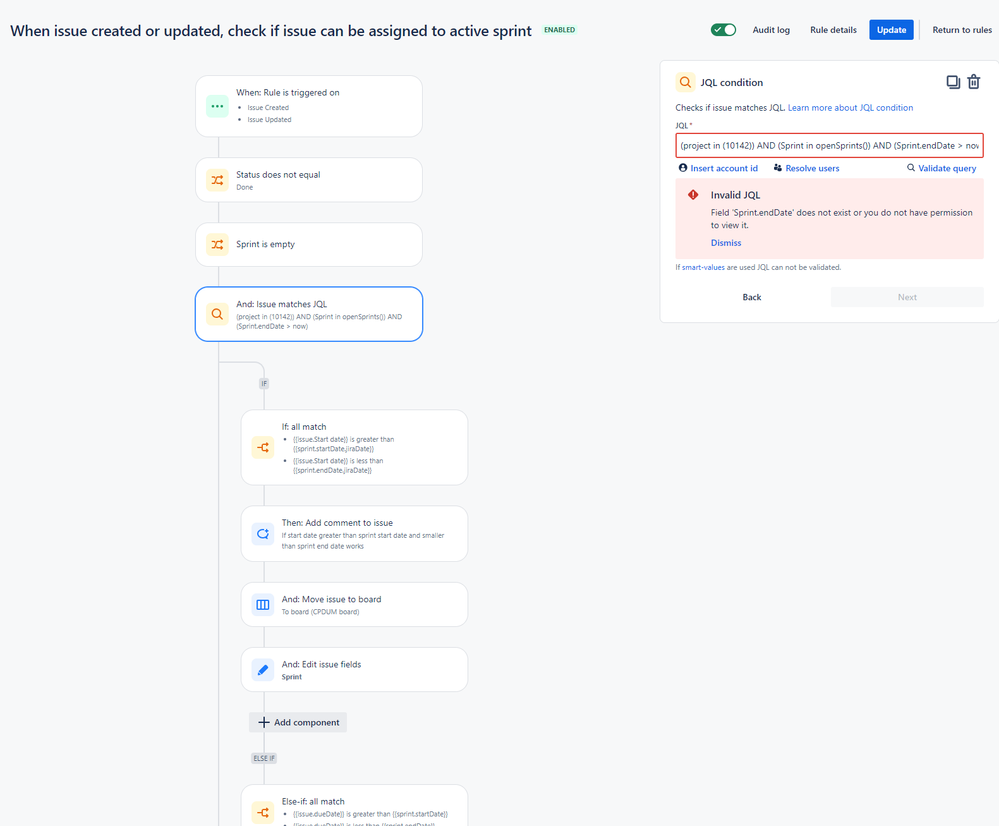

We are attempting to create the automation rule described below, but we encounter an invalid JQL error (see screenshot).
Rule: "If there is an issue with a start date or due date falling within the duration of a Sprint, then automatically move that issue into the Sprint."
JQL: (project in (10142)) AND (Sprint in openSprints()) AND (Sprint.endDate > now)

The sprint attributes (such as endDate) are not available with the built-in JQL features.
And the rule is trying to compare an issue's fields to an active sprint which the issue is not in, and so the data is not available.  I know of two ways to get those sprint attributes with a rule:
  1. Assuming a sprint has started and there are issues in it, use the Lookup Issues action with JQL to find those issues, and use the data from an example issue in the sprint.  One challenge with this approach is if any issues have been in multiple sprints, and so the list of sprints must be filtered to confirm they are "active".
  2. Using the Send Web Request action, call the Jira REST API to gather the sprints for the project, filter by the "active" state, and then use the attribute data.

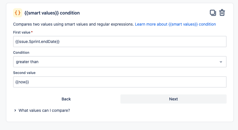

Sprint.endDate is a automation smart value. You can't use it in JQLs.
You can use the smart value condition and do something like this: {{issue.Sprint.endDate}} greater than {{now}}
If above doesn't work, you might have to work a bit with the format.
You read more about working with date smart values here: here: https://support.atlassian.com/cloud-automation/docs/examples-of-using-smart-values-with-dates/

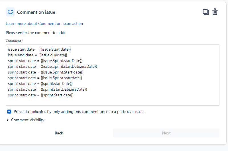

When trying just with
{{sprint.startDate}}
{{sprint.endDate}}
it returns nothing, even if I just try to print it (in a comment for example).

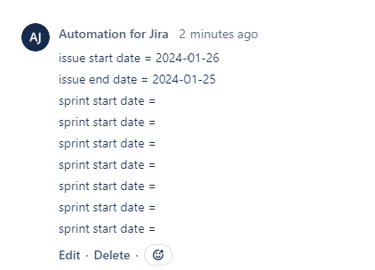

Here are some snapshots of trying to use smart values:
for example, add comment to issue (with empty Sprint), just to try to reach the value:
The comment added to the issue is empty:
