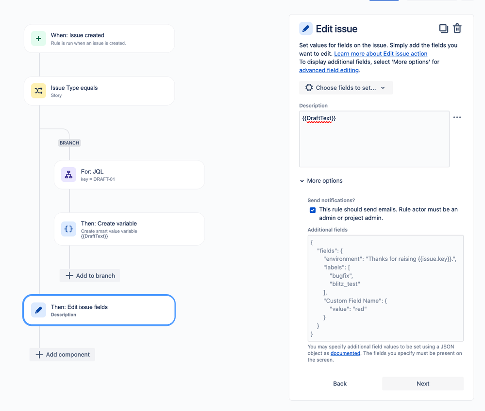

In this scenario, I have a Task (DRAFT-01) and I want to reuse the description from this task when a new User Story is created.
I created a variable {{DraftText}} to fetch the issue description {{issue.description}}
Both Task and new user stories are under the same project, however they're no related in any other way.
Would this be the right approach for this scenario?

First thing: what do you want to happen to the existing description in the created issue: add to it, replace it, something else?
Next, this will not work as your rule is shown, because...
  • with the branching, the created variable will go out of scope when the branch completes, and disappear
  • branches like this run in parallel and asynchronously, and are not guaranteed to finish until the end of the rule; thus that last edit may occur before the branch finishes!
As you are using Data Center version, you may instead use the Lookup Issues action with your JQL.  That will load the data for the "draft text" issue, for use later with:
{{lookupIssues.description}}
Some suggested changes to your rule could be:
  • trigger: issue created
  • action: re-fetch issue (It is advised to use this action after the Issue Created trigger due to possible timing problems.  Otherwise, the trigger can fire so quickly that some fields will be empty.)
  • condition: issue type is story
  • action: lookup issues, with JQL to get your draft text issue
  • action: edit issue, making changes to the description as needed

Thanks Bill !
This worked perfectly, it added to the description in the created issue.

Just to confirm, did you want to add to, or replace the description?  If it was "add to", your field edit could look like this to add the draft text after the original value:
Like Luis Villamizar likes this
Luis Villamizar
March 7, 2024
Correct, I wanted to add to the description so
keeps the original text from Created Issue and its not overwritten by
Bill Sheboy
March 7, 2024
Then if you include both smart values as I show above, that will add the draft text afterwards.  Please try that and let me know if it works as you expected.
