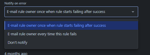

If you are looking to get an email when an automation rule fails you would select that option under rule details and chose whether the email goes to the owner or the someone else.

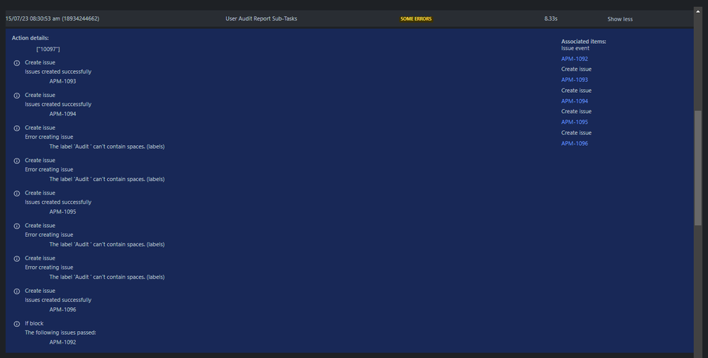

Additionally, it does appear that you get an email when some errors occur as well, because I received an email for this automation that only had some errors, though it had me log into the system.
As far as I am aware there is currently no way to modify the automated email that is sent out letting the rule owner know that the rule failed. But when you click into the audit log you can see the details as to why it failed or in this case, what failed.

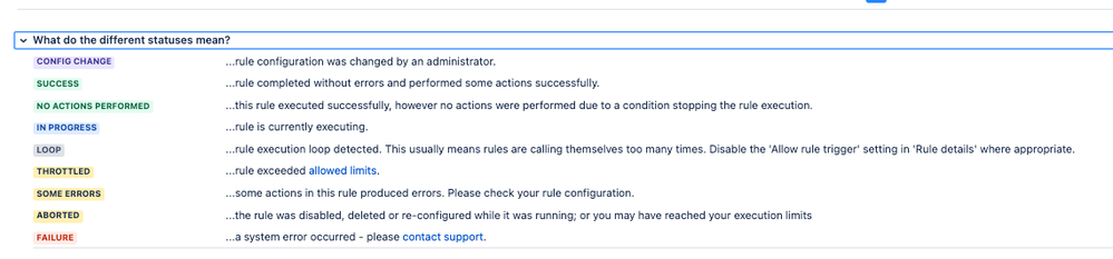

The option on the Rule Details page (shown in first image in @Collista Lewingdon 's Answer) will send an email based on the Status of the execution (shown in the second image) . I know it will send an email for "Some Errors", which is a yellow status. I'm not sure if it sends email for all yellow statuses, or for the gray status. I assume it would send an email for the red status.
I have seen rule executions where the Status is one of the green statuses, but when I looked at the details of the individual execution of the rule I saw a detail that I considered to be an "error" but Jira did not. Not all errors at the rule step level will cause the rule overall to error or fail.
