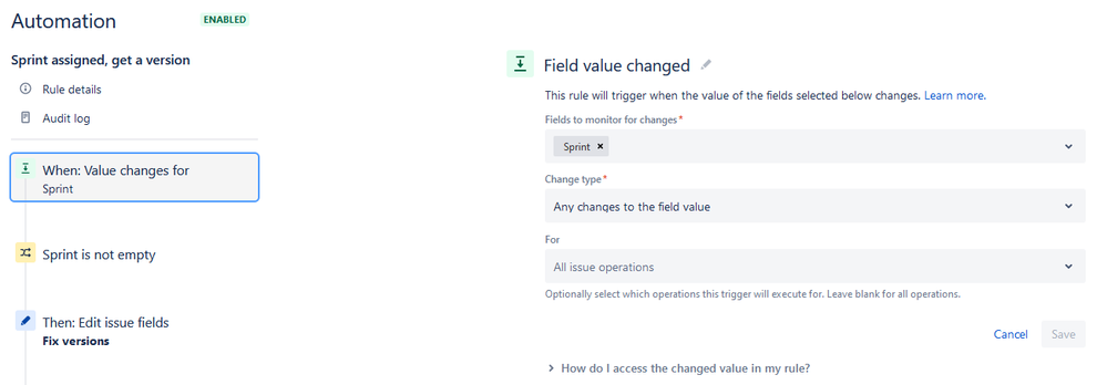

  3. when the sprint field is edited for an issue (trigger), check if it is in the current open sprint without a version assigned, and if so, assign it

I mostly focused on #2 and #3, but like I said on the first post, they don't seem to trigger at all
As if the Sprint field was different to other fields

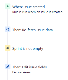

I just did some quick tests and see no problems with rule triggering, for team-managed projects, creating in either the backlog or current sprint. (case # 2, above)
Would you please post images of your current rule and of the audit log details?  Those may help clarify what is happening.
Martin Arana
January 2, 2023
Just learned about the Log and Re-fetch Action 🤯
Didn't understand at first what you meant by re-fetching it, didn't think there was an action that would refresh the data to it's latest state
This is now working perfectly, many thanks 😁✨

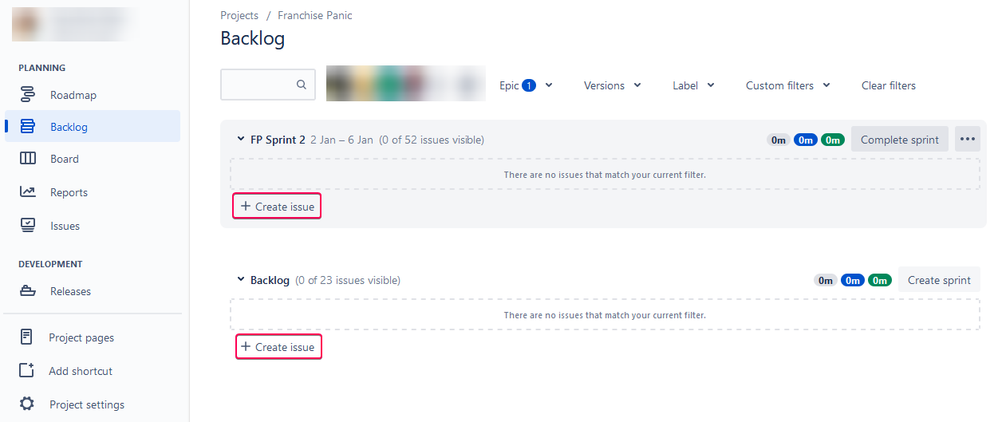

What steps are you executing to create the issue "in" the Sprint? Are you filling in the Sprint field in the Create Issue dialog? Or, if you are in a Team Managed project, are you using the Create Issue option that shows in the Sprint area on the Backlog screen?
Please show us the Audit Log for the execution of the rule you've shown when you create a new issue both within and outside of a sprint.
Martin Arana
January 2, 2023
This is a Team Managed project
The usual way we go about it is to create the issues on the Backlog View, using the "+ Create issue" buttons
Adding them either on the current sprint if it's something we need soon or on the backlog for future reference
