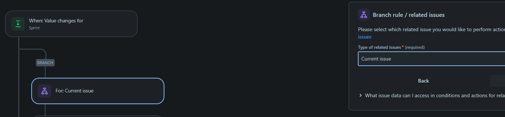

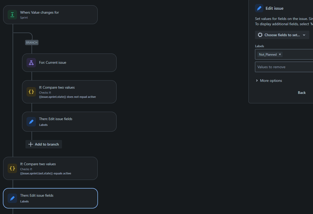

Patricia Caballero Leal
March 13, 2025
Hi all,
This is exactly what I need to do but I am not sure if I am doing it on the right way since it is not working to me.
Can someone check what am I doing wrong?
Bill Sheboy
March 13, 2025
In your rule's Edit Issue action, the smart value is in the field for Labels to Remove.  Please clear that and put it in the Labels to Add field.  And then re-test.
If that does not help...please post images of:
  • the Create Variable action
  • the updated Edit Issue action
  • the audit log details showing the rule execution, with all of the expand areas on the right side > opened up

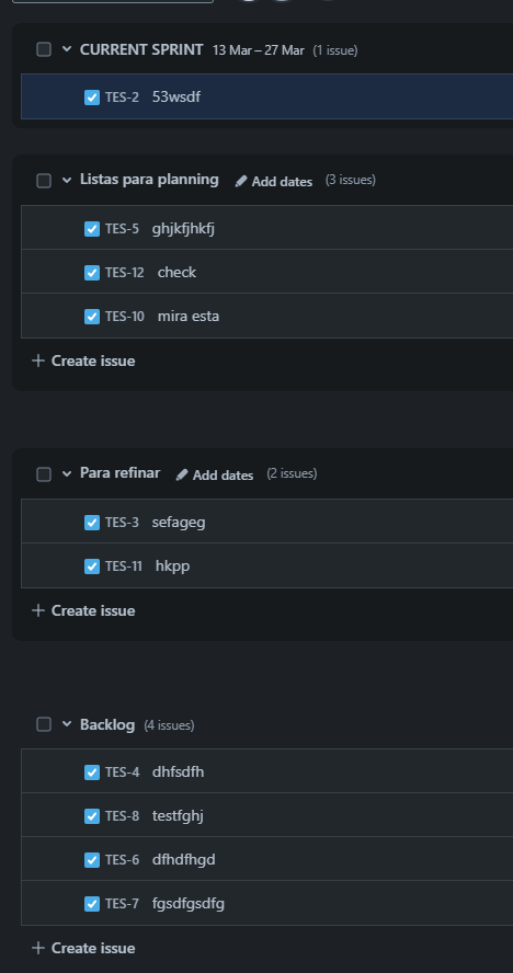

It is not working with the changes you suggested. However, I am not sure if this is exactly what I need since we have 3 sprints: 1."Para refinar", 2."Para refinar" and the current sprint.
Only the current sprint has dates and I need to add labels only to the issues added to the current sprint after the sprint started.
I have tried many automations with conditions and also the solution you posted here, but nothing is working and I really don't know what else I can do.
Your help with this problem would be more than appreciated.

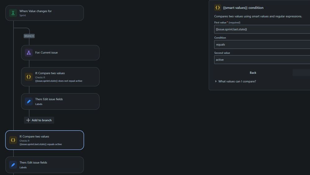

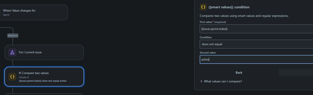

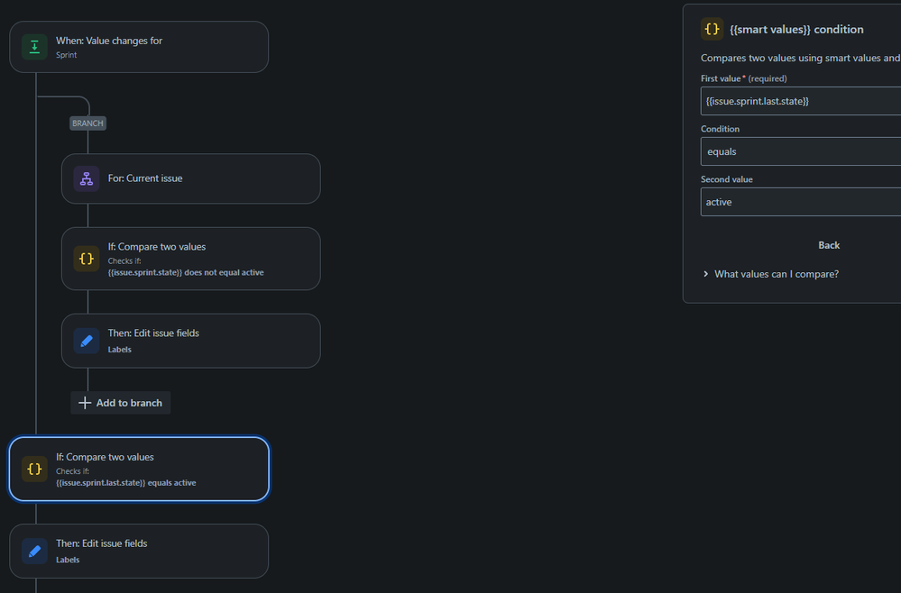

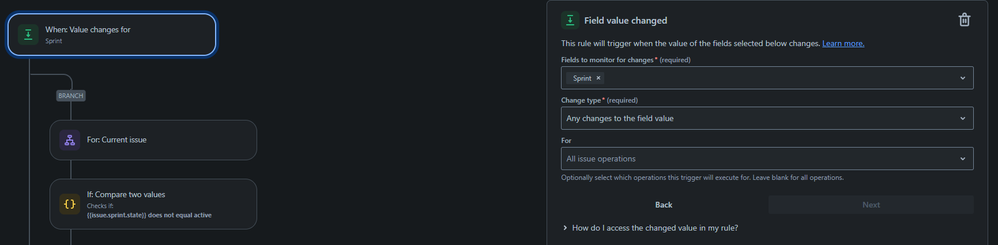

March 17, 2025
Thank you for your response Bill,
I have been able to create the automation to add a label when an issue is added after the sprint started only for the active sprint so that is not added in previous stages. This automation is also removing the label when the issue is taken back from the active sprint to previous stages.
trigger3.pngtrigger2.pngtrigger 1.pngCaptura de pantalla 2025-03-17 110739.pngCaptura de pantalla 2025-03-17 110723.png
The audit logs are all successfull:

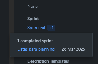

The only problem I have now is that this label is not added when the issue when trough different active sprints like this:
¿Any idea on how can I solve this last issue?
Thanks in advance.
Bill Sheboy
March 17, 2025
Thank you for those images.  I see two problems with the rule you show:
First, within an issue the sprint field is a list of values.  And the condition inside of the branch is checking {{issue.sprint.state}} That could produce a list of values, such as:
closed, closed
or
closed, closed, active
Perhaps try testing this way with the smart values condition to detect when the issue is not in the active sprint:
  • smart values condition
    • first value: {{#issue.sprint}}{{#if(equals(state, "active"))}}{{name}}{{/}}{{/}}
    • condition: equals
    • second value: leave as empty
This could also be tested more easily with a JQL condition on the issue:
(sprint NOT IN openSprints() OR sprint IS EMPTY)
Next, when a rule edits an issue in the cloud, it does not automatically refresh the data the rule holds.  And thus your update of the Labels in the branch is not visible to the rest of the rule, and so could fail the later condition.
When you want the updates to be visible, add the Re-fetch Issue action after the first edit action.
