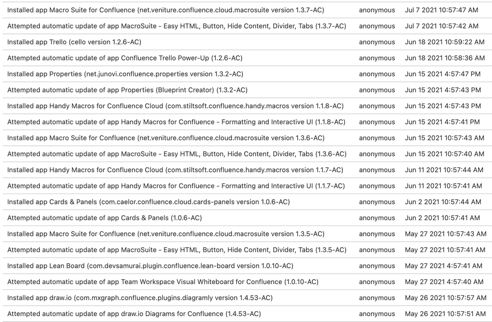

Tara L Conklin
July 13, 2021
Afternoon,
I just discovered the same problem occurring with nearly all of our Confluence Cloud extensions. I attached a screenshot of the audit log and you can see the mysterious 'anonymous' installation is occurring after an attempted automatic update.
Daniel Ebers
July 18, 2021
That would not be something I would worry much about. Like you said there was an attemped automatic update, a few second after that the log reads "installed", however by anonymous.
I think the alternative would be to read "installed by an automatic updater" instead of "anonymous".
