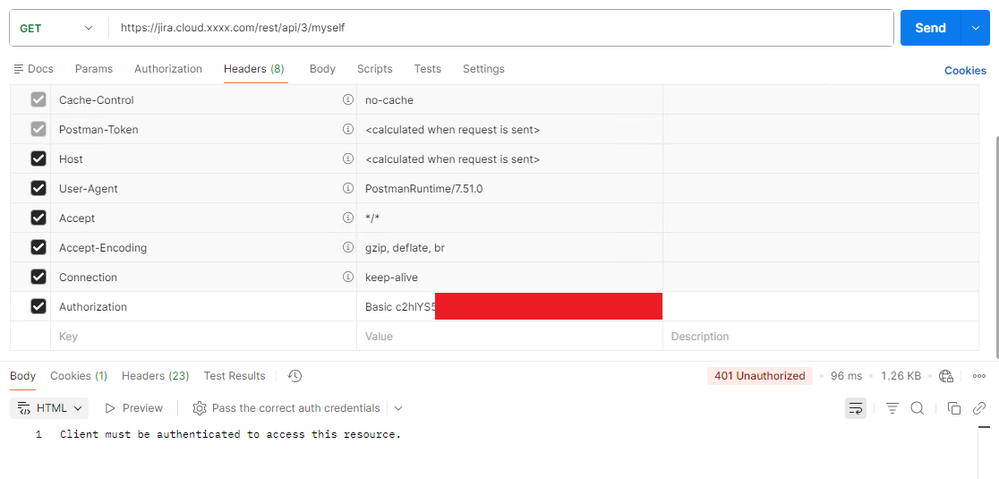

I know that for Basic Auth, I need to have it send a combination of my email and my API token which I got from https://id.atlassian.com/manage-profile/security/api-tokens. I've tried going to the Authorization tab, picking Basic Auth, entering my email for the Username, and my API key for the password. When I make the GET API call to that same path, but from Postman with my Basic Auth, I get the following error message:
Client must be authenticated to access this resource.
I know I can also BASE64 encode the combination of my email + semicolon + apikey and put it after the word "Basic" as the value for an "Authorization" header, but it seems like doing it through the Postman UI does the exact same thing; I confirmed the value it's building is the same as if I built the header manually, and tried manually doing it a few times instead instead of doing it through the UI for good measure, no difference.

I tried both with regular and scoped API tokens (for the scoped one, I just gave it every granular permission for editing or inserting issues), and tried both the UI and manual encoding ways for sending the Basic Auth header, and had no difference.
I've also tried changing the 3 in the URL to a 2 just in case, no difference there either.
I thought well, I'm not an admin at my Org, maybe I need to be an Admin? So I was given admin permissions, recreated both my regular and scoped API tokens, no dice. I also had our Jira admin try generating an API token and tried with their email + token, no dice. I had another developer doing the same thing on their end, no dice.

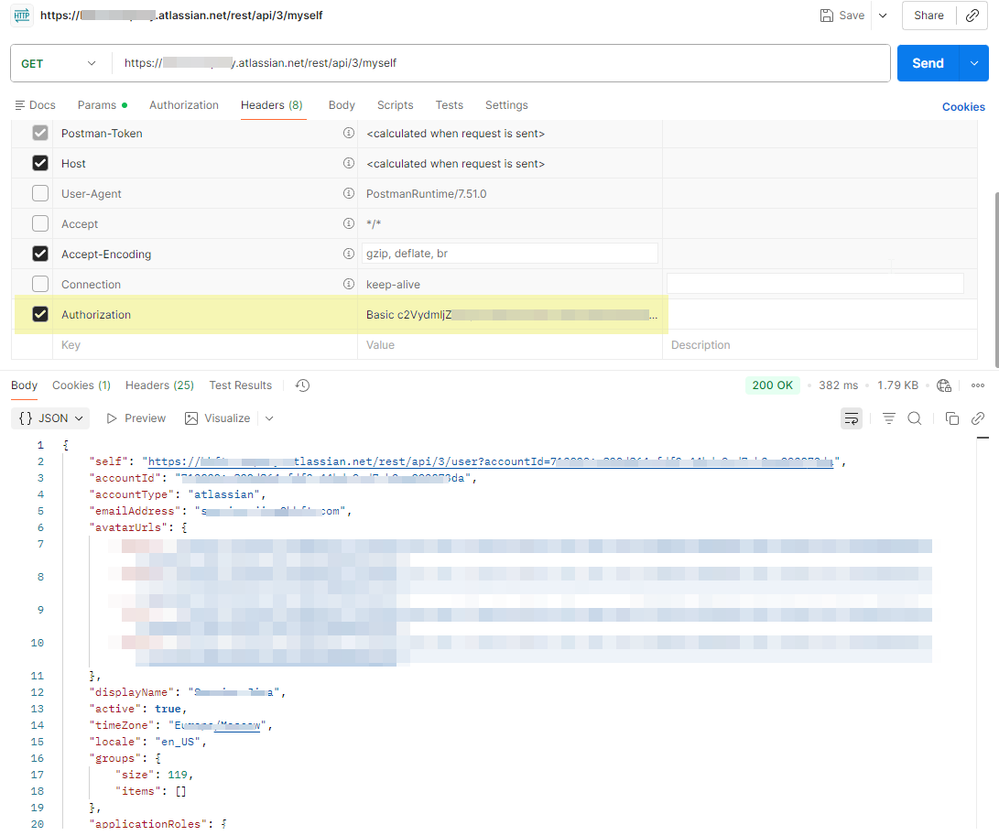

I finally figured it out!
I was trying to make the API call using our custom URL branding. (jira.cloud.xxxx.com)
I tried instead making the same calls but without the branding (xxxx.atlassian.net) and my Auth was accepted!
i.e. https://jira.cloud.xxxx.com/rest/api/3/myselfhttps://xxxx.atlassian.net/rest/api/3/myself

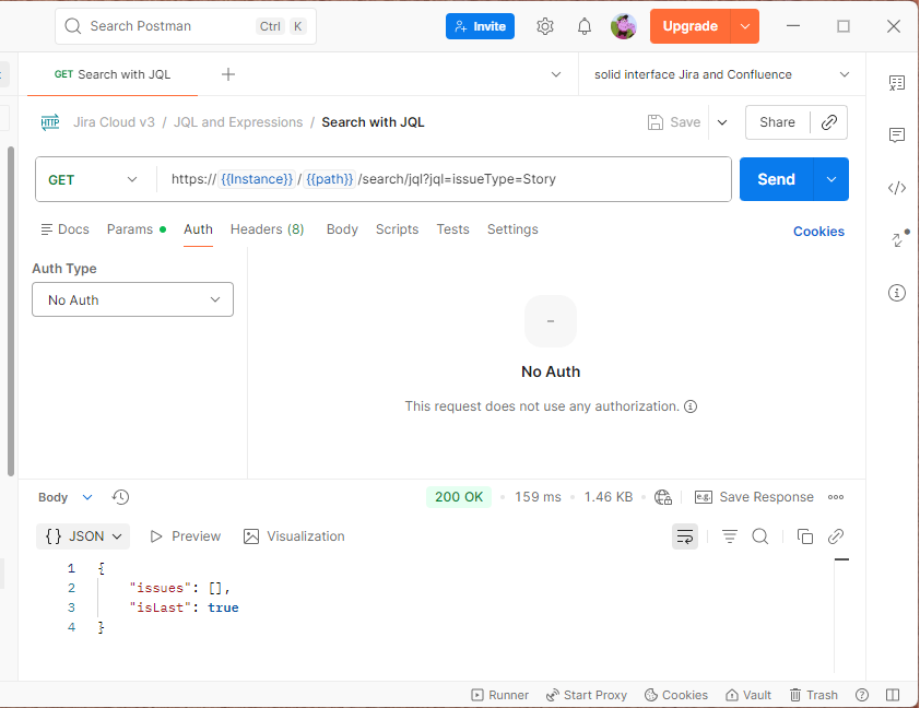

I'd recommend that you try an unauthenticated request to one of the endpoints that doesn't need authentication by default. A classic one is the Search for issues using JQL enhanced search endpoint. If you perform a simple JQL search for issueType=Story the request will be processed, return a 200 OK response, but no results:
If that works, you at least know the request path is allowed and routing correctly, and the REST API server can at least 'hear' the request and respond, it just couldn't perform the JQL search without authority.

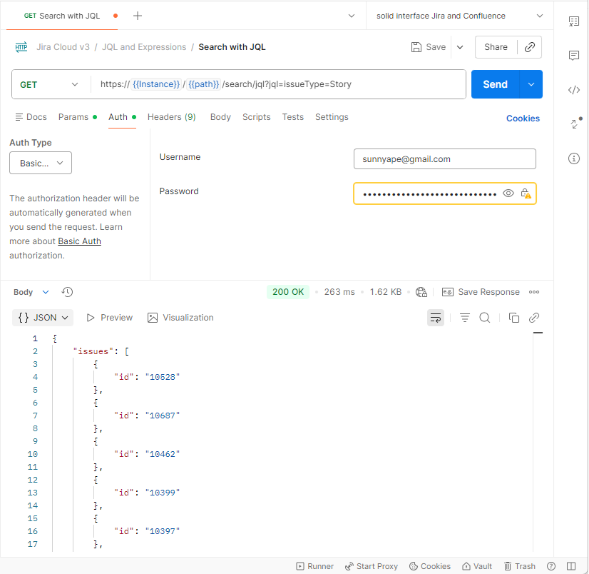

Next, if all is OK, change that request to basic Auth with the email:token combo (Don't even use a variable; type your actual email address and paste in your actual Basic API token!) and try again:
If the request works and returns a set of Work Items that are Stories, then you know the email:token combination is valid and works.
If the request still does not return any Work Items, then you know the email:token combination is invalid and can mean only three things:
  1. That token doesn't belong to that user with that email address;
  2. The user to whom that token belongs doesn't have Browse projects permissions;
  3. The token itself is invalid. (IE, incomplete, expired, not Basic type but scoped / OAuth type etc).
Once you isolate your problem down to where the fault is occurring, you are most of the way to resolving it.
