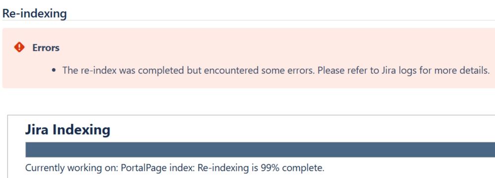

I'm trying to run the full re-index with Jira 9.12.11 but I'm always getting the following error:
The logs are only showing some errors:
025-02-12 13:13:42,886+0300 JiraTaskExecutionThread-1 ERROR evberez     [c.a.jira.task.TaskManagerImpl] Task 'Jira Indexing' failed.
com.atlassian.jira.index.IndexingFailureException: Indexing completed with 1 errors
    at com.atlassian.jira.util.index.CompositeIndexLifecycleManager.reIndexAll(CompositeIndexLifecycleManager.java:88)
    at com.atlassian.jira.util.index.CompositeIndexLifecycleManager.reIndexAll(CompositeIndexLifecycleManager.java:51)
Also, there is "NonUniqueResultException" in the logs:
2025-02-12 11:43:45,403+0300 JiraTaskExecutionThread-1 WARN xxx_user     [c.a.jira.index.AccumulatingResultBuilder] java.util.concurrent.ExecutionException: com.querydsl.core.NonUniqueResultException: Only one result is allowed for fetchOne calls
java.lang.RuntimeException: java.util.concurrent.ExecutionException: com.querydsl.core.NonUniqueResultException: Only one result is allowed for fetchOne calls
    at com.atlassian.jira.index.FutureResult.await(FutureResult.java:29)
    at com.atlassian.jira.index.AccumulatingResultBuilder.collectResult(AccumulatingResultBuilder.java:93)
I tried all solutions from this article
https://confluence.atlassian.com/jirakb/troubleshoot-a-reindex-failure-in-jira-server-429917142.html
but nothing helps.
Has anyone had the same problem?

Hi John. Yes, I did.  Finally, I used Jira's index analyzer that helped me to find 5 broken issues. I could not delete these issues. So I  was forced to delete records for 5 issues in the database (jiraissue, changeitem, changegroup, customfieldvalue, issuelink, os_currentstep tables). After this, the reindex was successful.

I would dig into step 5 about a plugin. In a test instance, disable all customer installed plugins and run a reindex. See if it fails. If it does, then there is corrupted data in the database. If it works, then re-enable the plugins one at a time and run a reindex after each one is re-enabled. This is very tedious, but is one way to narrow down the problematic plugin.
If the error is in the DB, then look at increasing the log level around reindexing to see if you can work out which issue (or DB table and field) is the problem. I think I'd follow up with Atlassian support after that.
Ekaterina Berezutskaya
February 14, 2025
Thank you. I disabled all customer plugins but a reindex failed again. Now I'am trying to find DB error...
