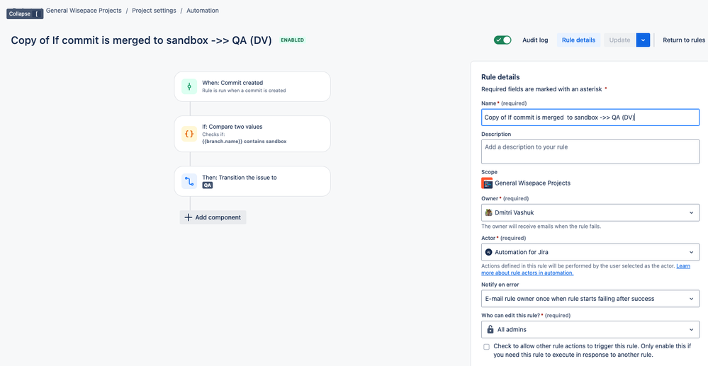

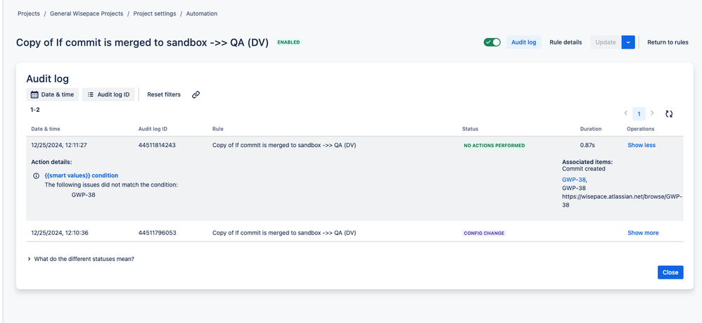

Hey Did as described, nothing happens despite I committed to sandbox.
What I did in a wrong way?
Screenshot 2024-12-25 at 12.12.26.pngScreenshot 2024-12-25 at 12.12.42.pngScreenshot 2024-12-25 at 12.13.17.png

Disclaimer: I don't have a Jira environment that is integrated with development tools so I cannot execute rules that relate to commits, branches, and pull requests.
What is the output in the rule execution Audit Log for when this rule runs? That should tell you if the conditions are passing or failing. It should also tell you if the Transition Issue action is able to execute, and if it isn't then it should tell you why.
You may also want to insert Log Actions immediately after the Trigger and before the Conditions.
https://support.atlassian.com/cloud-automation/docs/jira-automation-actions/#Log-action
Use those actions to print into the rule execution Audit Log the actual values of the smart values you are trying to evaluate in your Conditions. That way you can confirm those smart values are set as you expect them to be.

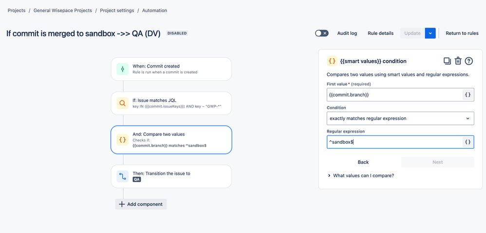

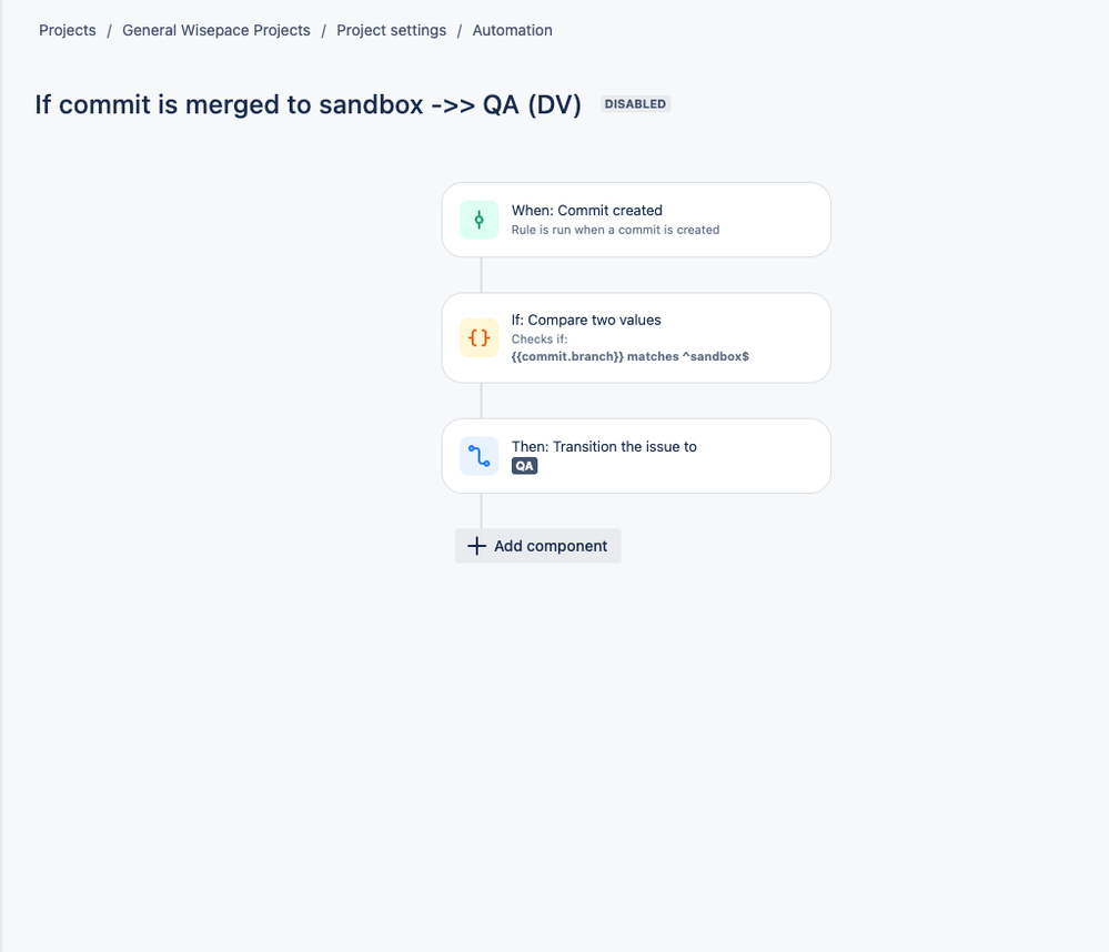

Here is how I tried initially, commit branch condition is not working here.
No actions performed. Despite commit branch was sandbox

My understanding is the branch smart values are only available with the branch-related triggers, and not the commit ones.
Did you try writing the smart value you are testing in the condition to the audit log to observe what it contains?  That is what both Trudy and I were suggesting.

Now I know how to work with audit log extended options.
Seems that {{commit.branch}} is not working and it's not listed in documentation even as possible one (sorry chat GPT, you were wrong).
