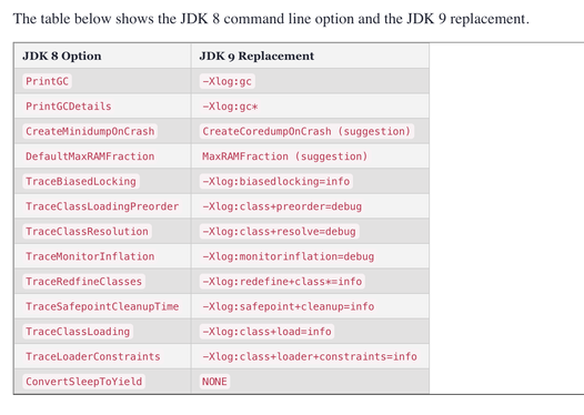

while you state you are still using Java 8 we see no evidence as from your posting nowhere a version number can be seen.
The following knowledge base article, indeed, states clearly this is happening when applying the parameter "PrintGCDateStamps" on Java 11.
https://confluence.atlassian.com/jirakb/garbage-collection-log-settings-for-jira-when-using-java-version-11-981148994.html
Without deeper knowledge of your system I don't believe further analysis will be possible except from stating the above.
Best guess: check your setenv.sh file for occurrence of the "PrintGCDateStamps" flag and remove it accordingly - at least for a test.

on which version did you start your jira? 8 or 11 ?
Please, be aware the parameters was changed for the Java 9
