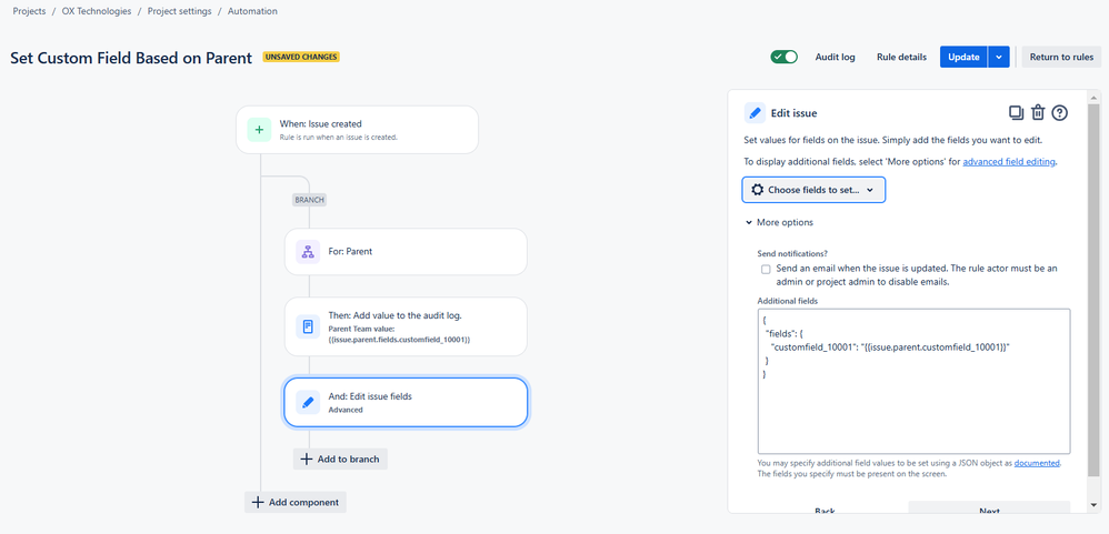

I've been trying to set an automation for field Team that is used by advanced roadmaps. I want to automatically set child issue Team to be same as Parent. With below JSON code the automation runs successfully, but the issue field is not being populated.
{ "fields": { "customfield_10001": "{{issue.parent.customfield_10001}}" } }
In my automation I have also included a log to see if the parent Team is read OK, and the log shows: Parent Team value: d458a753-47c4-4fde-ae80-63304af11702.
I also tried to directly enforce above Team to the issue being created but this also ends up in field not being populated. How can I force the child issue field to populate?

Trudy P Claspill
February 10, 2025
Hello @Karolina Yeong
Is this you current rule?
If so, this will not achieve your goal.
With the branch "For Parent" you are shifting the focus of the rule from the trigger issue to the Parent of the trigger issue. Actions that you take inside of the branch will affect the Parent issue, not the trigger issue. Within the branch use of the {{issue}} smart value will refer to the Parent issue, not the trigger issue.
You initially said you had a rule that included the Log action to print the value of the Team field. Can you revert to that version of the rule and show that to us?
Karolina Yeong
February 10, 2025
This is what I have now: example2.png
the log returns: Parent Team value: d458a753-47c4-4fde-ae80-63304af11702

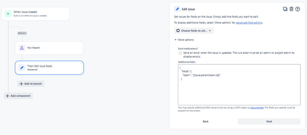

Karolina Yeong
February 10, 2025
@Trudy P Claspill the suggestion of removing the branch seems to have done the trick! I was trying to use the Jira AI assistant and this is where the branch had come from :)

Karolina Yeong
February 10, 2025
This is what I have so far:
When a child issue is added to parent, I want the child issue to inherit Parent's Team. example.png
