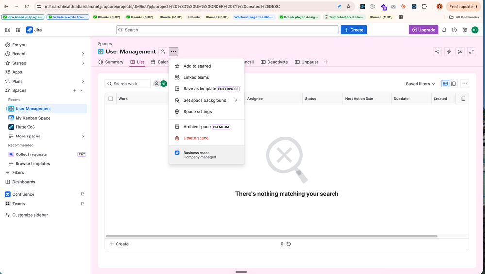

I'm experiencing a critical issue with our Jira Cloud Free plan instance where our Jira Service Management (JSM) business-type project (key: UM, User Management) appears completely empty in the board/list view.
Details:
  • Project: User Management (UM) — JSM Business project with ~250 issues
  • Issue started: Last Thursday (June 26, 2026)
  • Symptom: Board shows "There's nothing matching your search"
  • Root cause: JQL query project = UM returns 0 results
  • Verification: Direct issue lookup works fine (UM-267 accessible directly)
  • Board filter: Correctly configured — project = UM ORDER BY created DESC

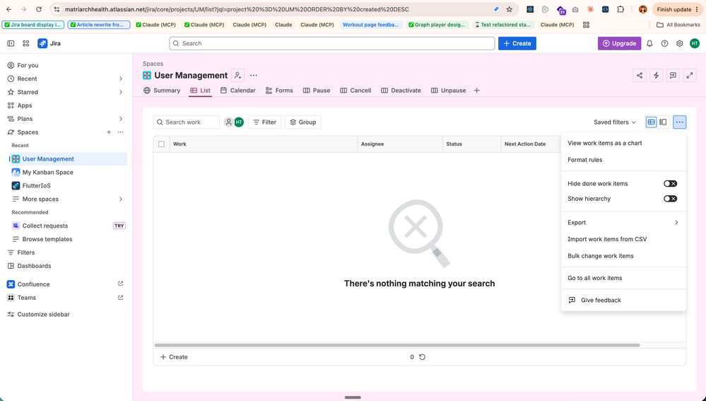

  • ✓ "Hide done work items" toggle doesn't fix it

Do you see the Space listed in the navigation bar on the left? If so, can you please click on the ellipsis next to the Space name and tell us what the last two lines in the pop-up say? It will be something like:
Service Space
Company-managed
I ask this because Service and Business projects are different project architectures, but you said it is a JSM business-type project. So I want to get confirmation on the project type.
Can you provide us with a screen image that shows your board where the message is displaying?

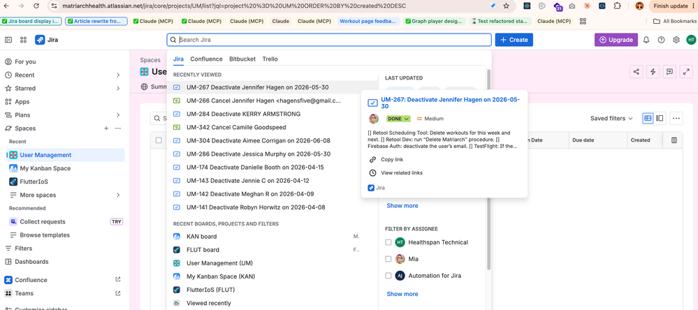

1. How I access UM-267:
I'm using the Search field at the top of the Jira screen (typing "UM-267"). As you can see in the attached screenshot, the search returns the issue: "UM-267
Deactivate Jennifer Hagen on 2026-05-30" from User Management project, recently viewed.
2. Project Type Confirmation:
I clicked the ellipsis (...) next to "User Management" and the last two lines say:
  • Business space
  • Company-managed
So it is confirmed as a Business project, Company-managed.
3. Screenshot of the empty board:
As shown in my previous message, the board displays "There's nothing matching your search" even though UM-267 (and ~250 other issues) exist in the project.

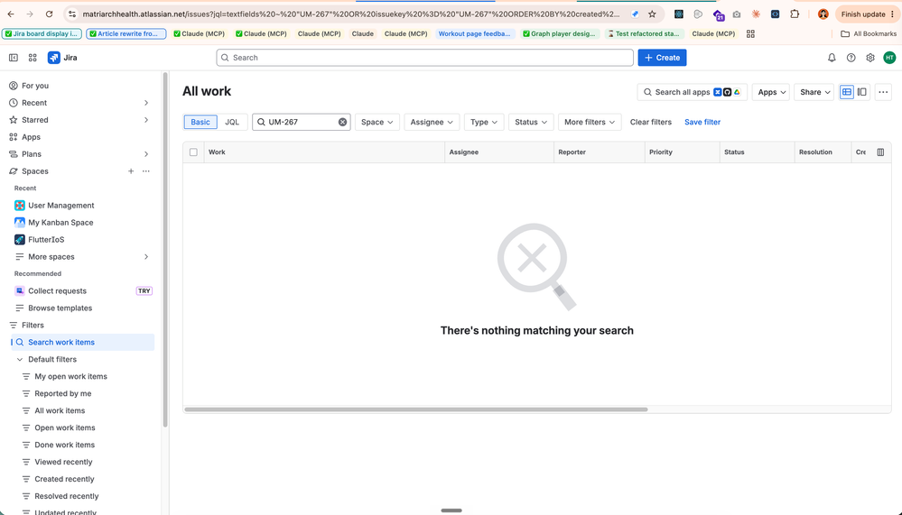

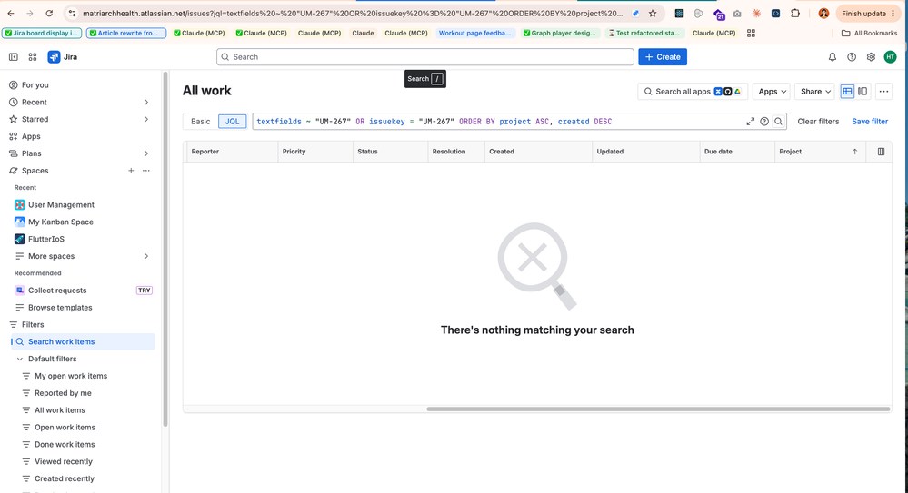

Can you confirm that you have tried going to Filters > Search work items (in the panel on the left) and executing a search for the issues either using the Basic search features or the explicit JQL?
Healthspan Technical
June 29, 2026
Basic search for "UM-267"
  • Searching by issue key "UM-267" returns: "There's nothing matching your search"
  • Even though I can access UM-267 directly via the top search box

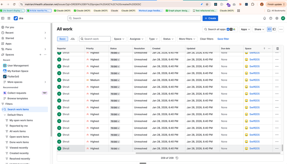

Basic search with NO filters
  • When I remove all filters and search without specifying any project, the results show 209 of 209 items
  • Not a single item from the UM project
Critical Finding:
The search index appears to be completely missing the entire UM project. When searching globally without filters, 209 items appear but none are from UM.

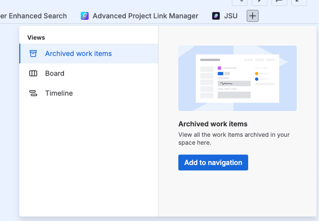

While viewing your business space (i.e. the screens you initially shared) can you click on the "+" icon in the tab bar and look for Archived work items and click on it and click the Add to navigation button.
Can you then check that tab to see if the issues are listed there?
When on a Free subscription it should not be possible to archive issues. But, if you temporarily upgraded to a Trial of the Premium subscription then it would've been possible for issues to get archived. That removes them from the search index and from all normal displays of issues. But it is still possible to access them directly.
FREE
