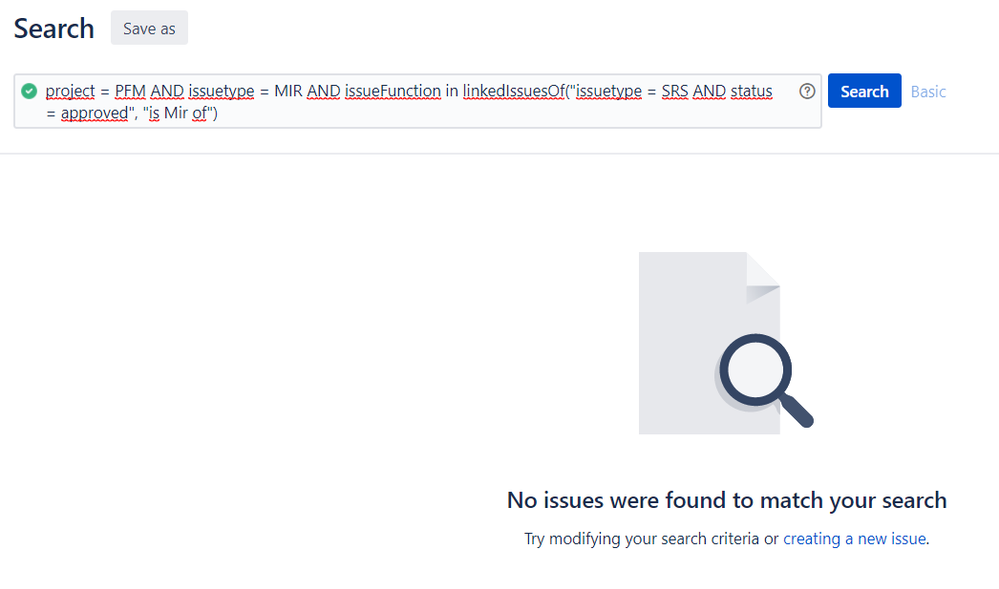

But here is what I get (screenshot)

Hi @CécileV ,
Thanks for the screenshots, I see the problem now!
Let's revisit the JQL:
issueFunction in linkedIssuesOf("issuetype = SRS AND status = approved", "is Mir of")
This part of the JQL says, find me linked issues of .....
So this part of the JQL talks about the linked issue, not the issue you ant to find.
As you might know, issuelinks have a name, and 2 parts, an inward, and an outward part:
In your JQL you ask for issues linked with "Is MIR of", yet in the issue you are looking for, the link is "Is MIR of".
Could you check the linked issue itself (PFM-3949) and check what the other half of the link is called?
That's the name you should add to the JQL ;)
Let me know if this works!
CécileV
February 3, 2021
Hi Tessa,
That's wonderfull, it works! Many thanks for your help :-)
Cécile.
