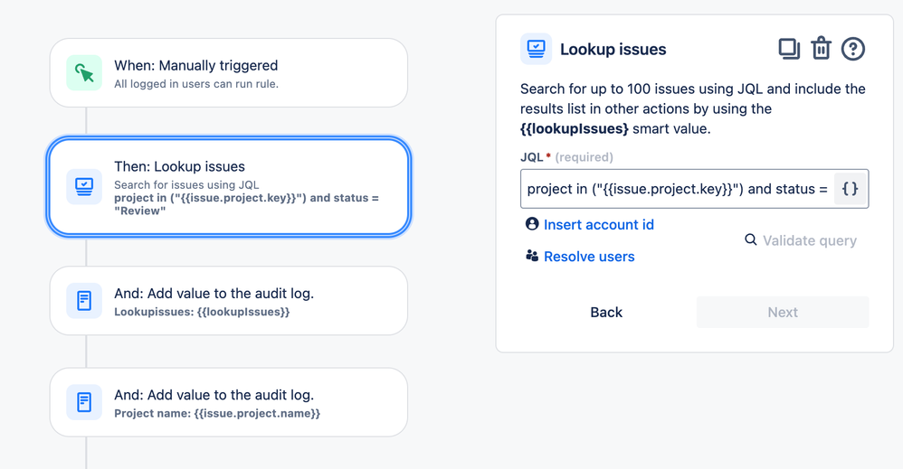

Hi @Wafa Hasnaghina Ulfah ,
I noticed that using 'project in' instead of 'project =' does the trick.
I tried this using a Manual trigger in combination with Lookup issues actions. And that works fine.
Hope that helps.
Rik

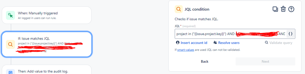

May 14, 2024
Hi @Rik de Valk _Brainboss_
thank you for the reply.
Yes, I tried with the project in ("{{issue.project.key}}") and it immediately and successfully triggered when I used the JQL Condition.
It turned out that the Scheduled Trigger with JQL that I use, returns the value of the project without needing to specify, so it kind of caused the error.
