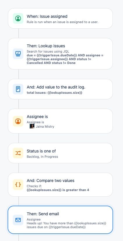

I'm trying to trigger the automation when an issue is assigned to a user. So I tried using
due = {{triggerIssue.dueDate}}
in lookupIssues.
But when I test the automation, there are no errors. The audit log it shows that the issues did not match the condition.
This leads me to think it's not possible to trigger this on issue creation.
Mikael Sandberg
March 5, 2024
Do you know the size of lookupIssues? I would add a log action to see what {{lookupIssues.size}} returns.
Jaina Mistry
March 5, 2024
That log action was key @Mikael Sandberg ! I didn't know I could do that.
The variable wasn't getting populated with a value because I did not use the write letter-casing for {{lookupIssues.size}}
Here's what the final automation looks like:
Thanks again for your help, Mikael!
