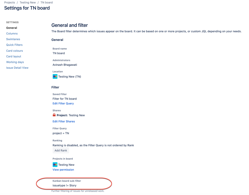

Hi @Todd Heath ,
The JQL query seems to be fine for the board , just to check sub filter which may try to hide the some issues from board. Share the sub filter for the kanban board.
Thanks,
Avinash
Todd Heath
November 1, 2019
Issue type doesn't filter out which of the issue type is in the backlog, and which are on the board. I need to know only those that are on the board, and not in the back lock of every issue type.
