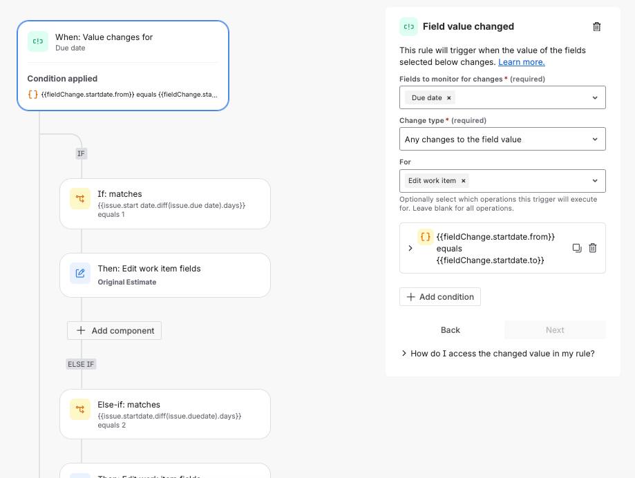

I would like to do the following:
Trigger:
  • If due date ist changed, but start date is not changed
Condition + action:
  • If: if due date is the same as start date => edit custom field A in work item
  • else: if due date is start date + 1 day => edit custom field B in work item
  • else: if due date is start date + 2 days => edit custom field C in work item
The "edit" part is just an example. The main question is how the if-else block should be created so that I can compare the due date and the start date. Because in the end I want to use the information how many days are in between due date and start date.

First you should remove the Condition that you have added within the rule Trigger. That is meaningless. {{fieldChanged.startdate}} is not a valid smart value in this case.

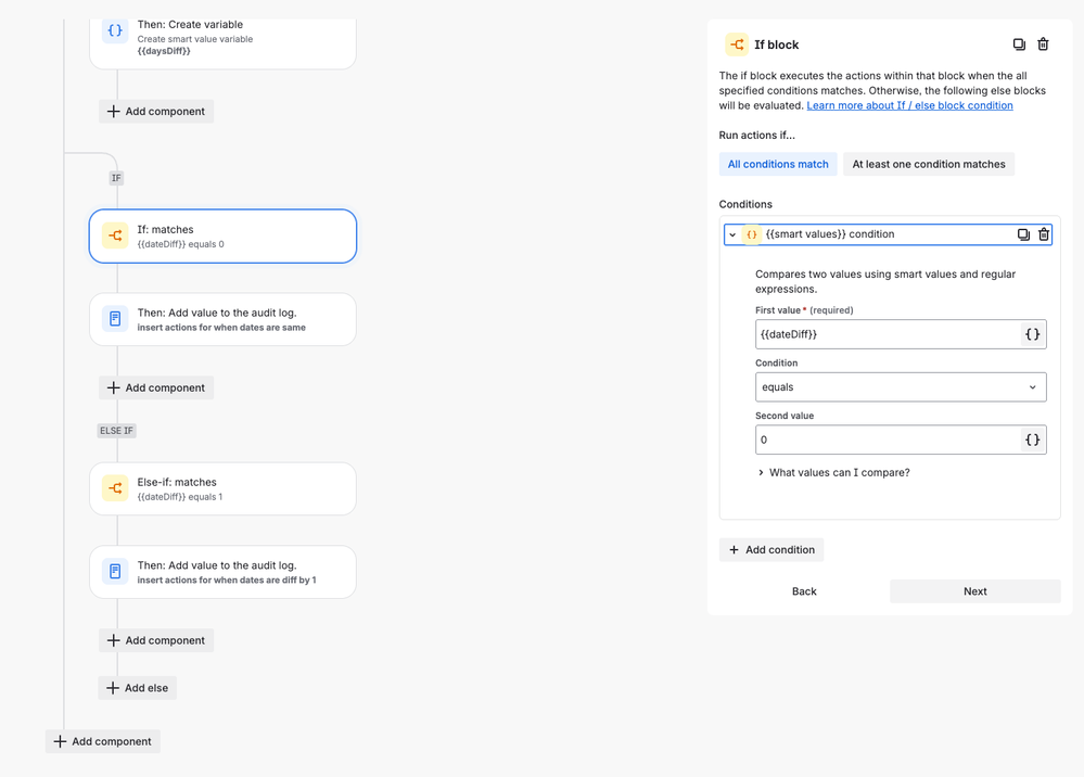

Some changes I would make to the rule are:

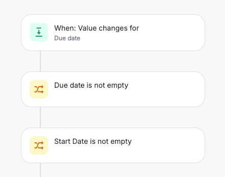

1. Add a condition after the trigger to confirm that the Due date field has a value.
2. Add a condition after the trigger to confirm that the Start date field has a value.

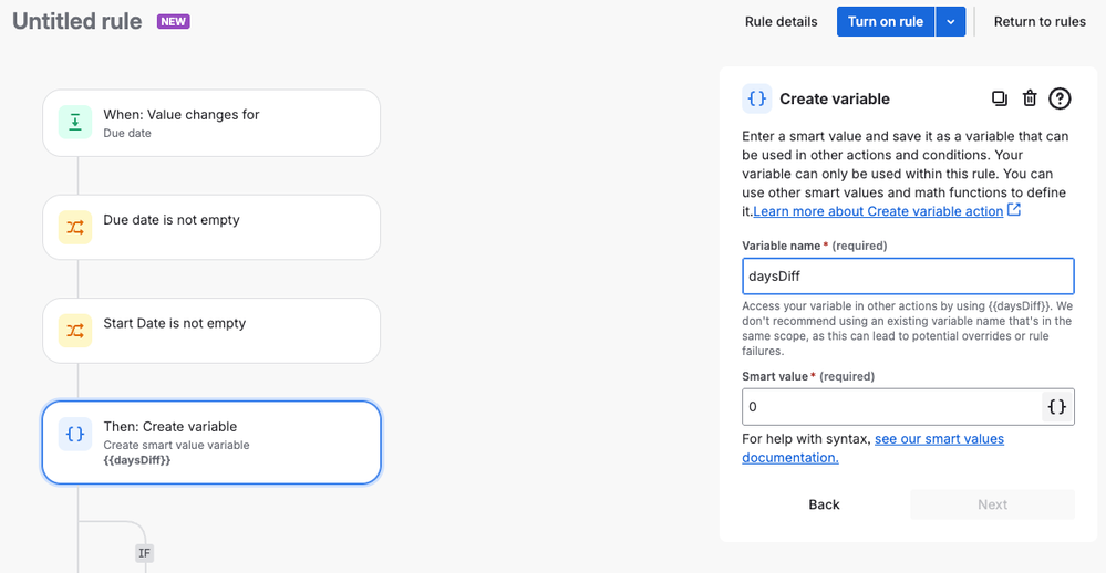

3. Add a Create Variable action and store the calculation of the difference between the dates in that variable and initialize it to 0 (no difference in dates)

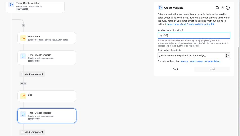

4. Then I would set up an If/Else block to check if the dates are the same and set the same variable to 0 if so, otherwise set the variable to the difference between the dates.
5. Then I would set up an If/Else-if block to check the value of the variable and take the appropriate actions.

Jack Brickey
December 18, 2025

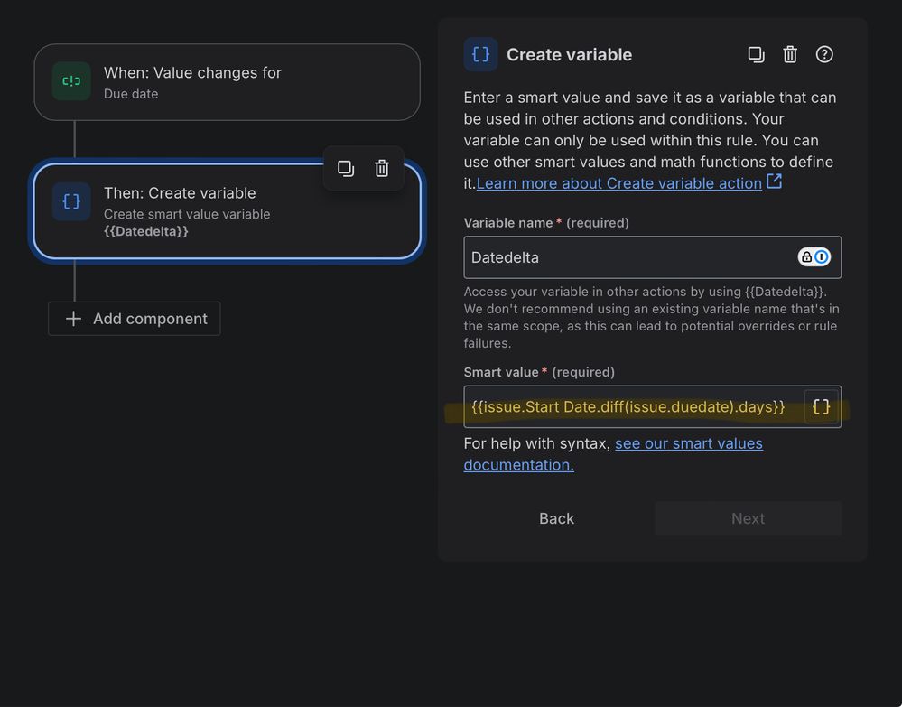

Hi @Simon Huprich , based on what I read here I would start with something like this where you create and store the difference between your two dates and then use if/else clause to use actions.

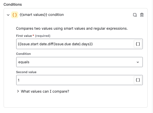

Simon Huprich
December 18, 2025
Hi @Jack Brickey
I already tried something similar, but it didn't work.
I wanted to integrate the comparison directly into a condition.
Any thoughts?
Jack Brickey
December 18, 2025
You can certainly do it without the variable. I just find using variables to be cleaner. If I need to change the smartvalue it is a onetime change vs. changing each if/else. I do not grasp the condition in your trigger. I think @Trudy Claspill hit on that very issue. You need to pull that out and create any unique conditions immediately following the trigger before any if/else.
