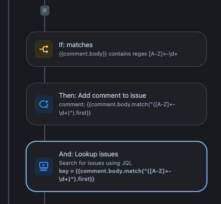

In a Jira automation, I cannot get a JQL query to work with lookup and a smart value. The smart value itself ({{comment.body.match("([A-Z]+-\d+)").first}}) works fine i.e. it looks correct when printed to a comment in the same Jira automation flow, but it returns 0 results when used in a lookup (according to the audit log of the automation). I can confirm that when used in a comment, the value of the smart value is correct, so unsure why it cannot be used in a lookup? I've also tried setting it to a dedicated var as a step in between but that didn't work either. Thanks!

For a question like this, context is important for the community to help.  Please post the following:
  • an image of your complete automation rule in one single image
  • an image of the full audit log details showing the rule execution
Until we see those...
Some rule actions can have order-of-evaluation / timing problems when evaluating smart value expressions.  The Send Web Request action definitely has this problem, and perhaps the JQL for Lookup Issues does also.
The way to check if this is the cause (and to solve it) is to first store the result of that expression using the Create Variable action. Then use that created variable in both your Log and the Lookup Issues action.

Based on the information available, it seems that the issue might be related to the pattern used in your smart value. The solution provided in the Atlassian content suggests modifying the regular expression pattern slightly. Here's what you can try:
Solution:
  • Modify the Smart Value Pattern: Instead of using {{comment.body.match("([A-Z]+-\d+)").first}}, try using {{comment.body.match("([A-Z0-9]+-\d+)").first}}. This pattern includes numbers in the project key part of the issue key, which might be necessary for your specific use case.
This adjustment should help the smart value work correctly in the lookup context as well. If the issue persists, ensure that the smart value is correctly set and that there are no additional constraints in your JQL query that might be affecting the results.
