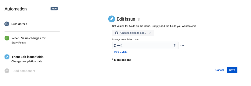

You can create a workaround however if you want to monitor this.
Apps like automation can make it easy to access the changes and can monitor on which field a change happens. If such a change happens, you could set a dedicated date custom field (e.g "Estimation date") and set it for every change against the field.
You could query on that field easily.
Hope it helps!
- Tessa

the same applies here, you can monitor the change of any custom field using Automation and add that date to the issue again.
You could script it yourself or use other apps than Automation of course, but the basic idea will remain the same, you need to add the date on the issue to be able to query on it.
Another way to look at it would be developing a custom JQL function. This method is described here.
- Tessa
