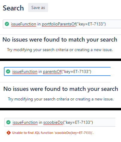

It's not clear to me if some ScriptRunner functions aren't enabled or what. I have project-admin privs (not Jira admin privs), so how would I know?
I can say that many functions like parentsOf() and portfolioParentsOf() do not appear in the auto-complete when I'm constructing JQL:
And when I try to use them to return even the most basic, known things, they seem to quietly fail:

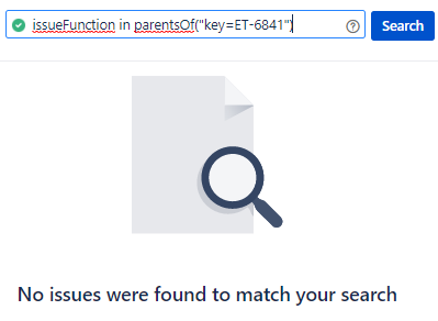

Mykenna Cepek
February 9, 2023
Still nothing:
That last query was to convince myself that whatever was after "in" really mattered.
ET-7133 exists, is an Epic, and has a Feature issue as a parent.

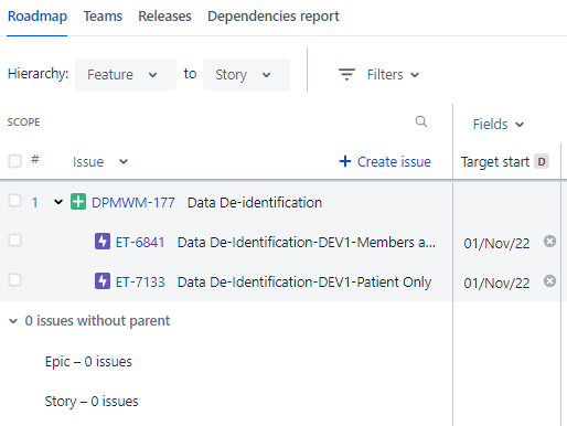

Can you show us a screen image from the roadmap that shows ET-7133 as a subordinate issue under another issue?
Mykenna Cepek
February 20, 2023

If you try the same filter and plug in ET-6841 instead, do you get any results?
Nope:

I also noticed this interesting result, suggesting that the parentsOf() function is available (since it can tell when such a function isn't available):
