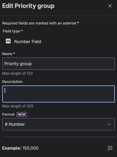

Would you please post an image of that custom field's configuration in the TMP, including any formatting options you are using? (e.g., currency, percentage, different units, etc.)

Thanks for that information, and...
Have you confirmed the field you are seeing in the endpoint response is that same field by comparing the custom field ID value?  I have noted other questions / posts where people had two different fields with the same name (one company-managed / global scope and another TMP) and were observing the wrong one in the data.
If that is not the cause, I am out of ideas on this one.
