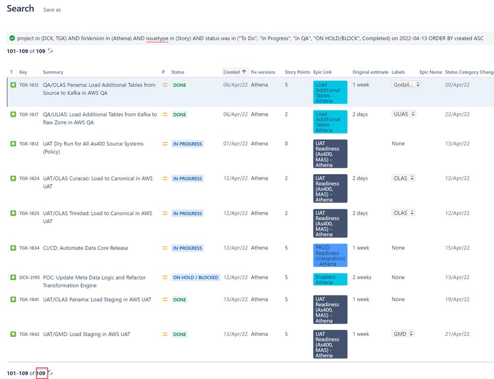

I have only the following statuses in my JIRA project:
'To Do', 'In Progress', 'In QA', 'ON HOLD/BLOCK', Completed, DONE and the BACKLOG
I am looking for stories on the following statuses: 'To Do', 'In Progress', 'In QA', 'ON HOLD/BLOCK', Completed on a given time.
I am using the following two queries and they provide different results and per my understanding it should not:
project in (DCK, TGK) and fixVersion in (Athena) and issuetype
in (Story) and status was in ('To Do', 'In Progress', 'In QA',
'ON HOLD/BLOCK', Completed)
ON '2022-04-13' ORDER BY created DESC

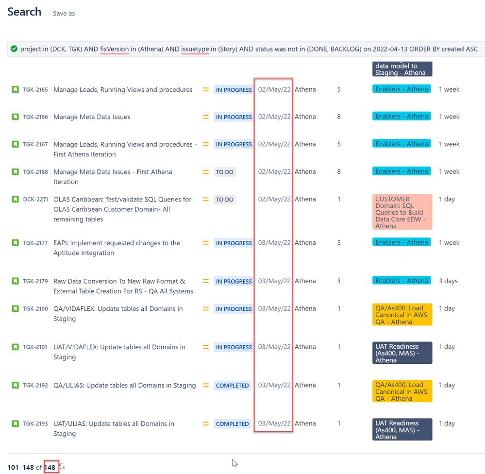

in (Story) and status was not in (DONE, BACKLOG) ON '2022-04-13'
on the first query I got: 109 issues and on the second one I got: 148
This is the result for the first query:
Result of the second query: as you can see it returns stories created after that referenced date:

Next, that second query result is interesting as it appears correct as the later created issues were, in fact, not in those status values on that date.  Perhaps try restricting by create date also:
project IN (DCK, TGK)
AND fixVersion IN (Athena)
AND issuetype IN (Story)
AND status WAS NOT IN (DONE, BACKLOG) ON '2022-04-13'
AND created <= '2022-04-13'

JQL does exactly what we ask (usually), and without the extra Created condition, your query is essentially saying "I do not care when these were created...just show issues NOT in this status on this day...", which would be everything else.

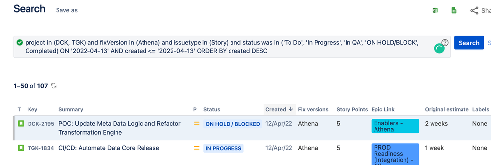

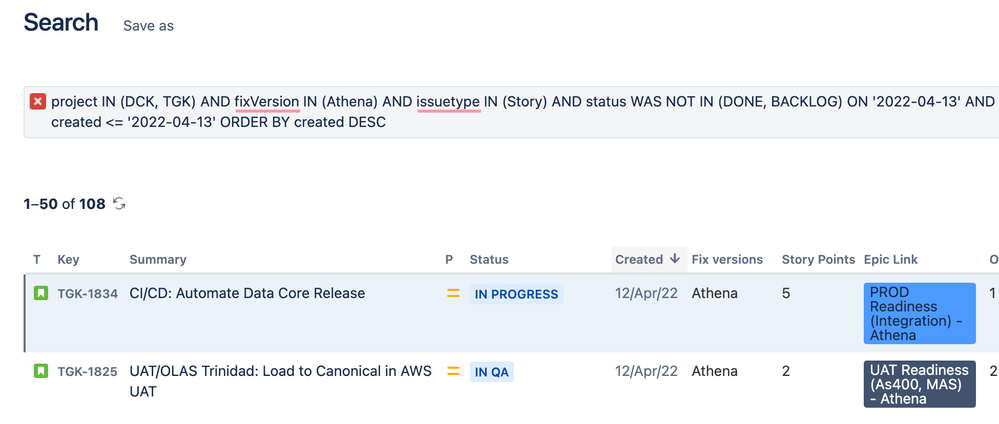

@Bill Sheboy I think you are correct, adding in both queries the created condition will reduce the differences in the number of stories returned. The WAS NOT missed on the story: DCK-2195 that was transitioned from Backlog to IN PROGRESS on 4/13/2022 and maybe some other added in order to return 108 vs 107
so I think there is a bug. The query checked also mark as an error (red x) after I enter the ON predicate.
