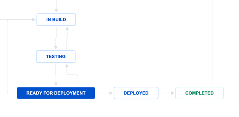

Is the "Deployed" status your final status in the workflow? Is it the only green status (the only "done" status) for your workflow?
If it is the only "done" status for your workflow, then the Resolution Date field should be getting set when issues transition to that status, and you could write a filter to check for issues where the Resolution Date is in the past week:

No, Deployed is not the final one.
Completed is the final one.
so what my requirement is that I want to filter out all the stories whose status were changed from "Ready for Deployment" to "Deployed" in past one week for a particular project i.e. project = XYZ AND ...... {further conditions go after this}.

Do you care what status the issue is currently in? If it was transitioned to Deploy in the past week and then also transitioned to Completed, and possibly re-opened (if that is a status it can go to after Completed) would you still want the issue in your results set?
